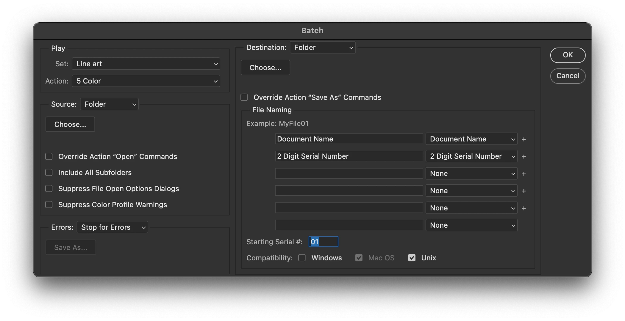

Dramenon
October 19, 2021
Batch has this built into the process...
File > Automate > Batch...
  • If you are Saving to a Destination Folder (your choice of folder) then you can have the Batch process handle File Naming.
  • For my example I used a 2 digit serial number, it starts with 01
  • This would end up being "filename01.jpg, filename02.jpg, filename03.jpg... and so on
Hope this helps.
/end of line/
October 19, 2021
Hi Daniel, Thank you that is very helpful, I will give try in out tomorrow. I knew it would be one button somewhere, I've only watched 3 batch editing videos now haha

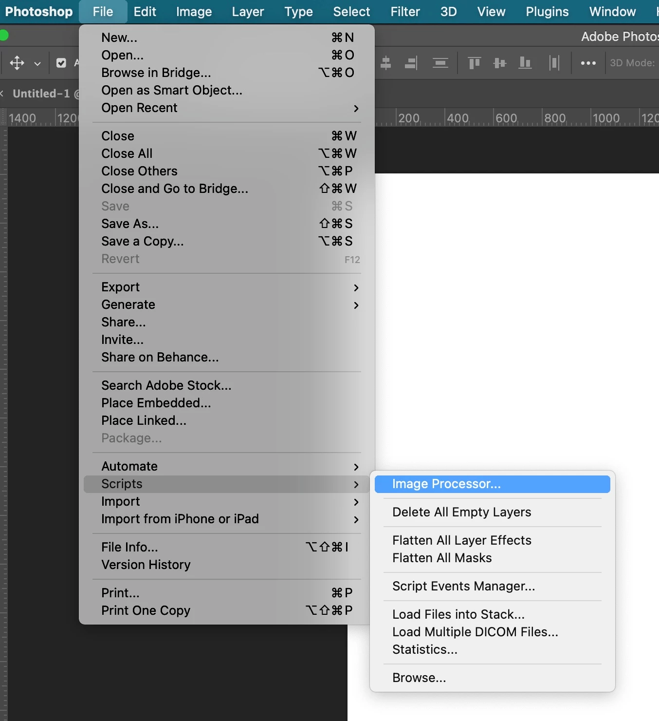

Grant H
October 19, 2021
Hi, use the image processor which you can customize a bit perhaps in your action:
October 19, 2021
Thank you Grant, I will take a look at this tomorrow. 🙂
