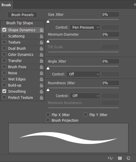

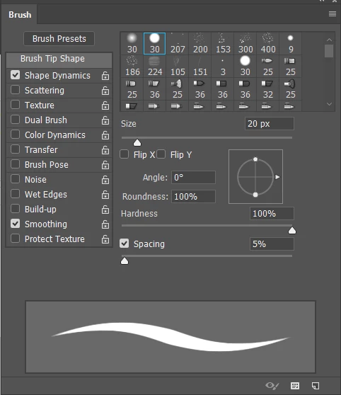

You need to reduce the spacing for a start. The brush is stamping down with quite gap
5% would work well.
It looks ever so slightly like either brush or layer might be set to Dissolve, but we'd need to be looking at a low zoom ratio for that to be true.   It would be easier to see it against a white background.
Have a flick though the brush panel settings for that preset.  Especially the Shape Dynamics and Transfer.
The bottom line here is that even a fully soft brush does not create totally smoove  gradients, and you need to apply Gaussian blur to finish the effect.

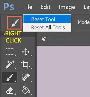

Looks like a special brush preset.   You could open the brush presets window and choose a more appropriate one.  Or you can simply reset your Brush tool to default settings.
Nancy
5% would work well.
