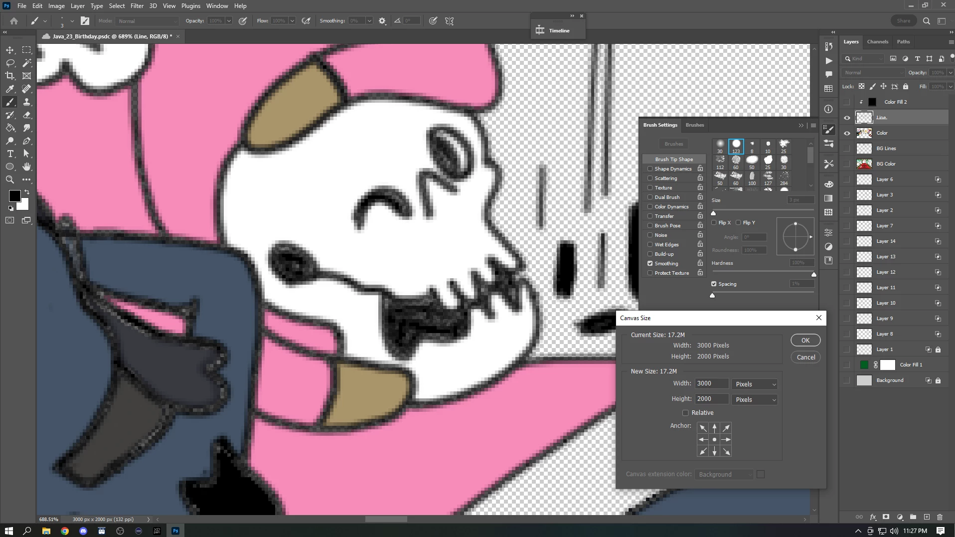

Photoshop Brush lines are pixelated and weak. Solutions?
When using the Brush Tool with a size of 3px, Hardness 100% (see brush settings below), lines come out weak and pixelated. Extremely noticable when there is color involved, but less noticable when a background is turned on. I'm at a resolution of 2000x3000px (not sure the dpi but I don't think I've changed anything). Would like to have crisper lines when using the brush. Alternatively, if anyone can suggest a method of filling in the lines without the bucket fill tool, I'd graciously accept that too!

I'm sure someone with better drawing skills will chime in, but a couple of things occur to me immediately:
  • your screenshot shows your document zoom at over 600% - lines will look pixelated at that zoom;
  • 3 pixels is a very fine line, pixels are square and they will never make a smooth line, there will always be some  stepping;
  • are you drawing two sides of your outline and then filling the gap to give you the thicker outline?
Have you tried a thicker brush? Changed any Brush Settings to help with Smoothing (to draw smoother lines)? Are your outlines on a separate layer above the colour?
Is this the way you've always been doing your art? I'd be trying a slightly larger brush, maybe even reduce the hardness slightly, crank up Smoothing to help me draw flowing lines, and basically just experiment until I found the magic point where I got what I needed. Also, remember to view your artwork at what will be its actual size to check for problems like pixelation.
