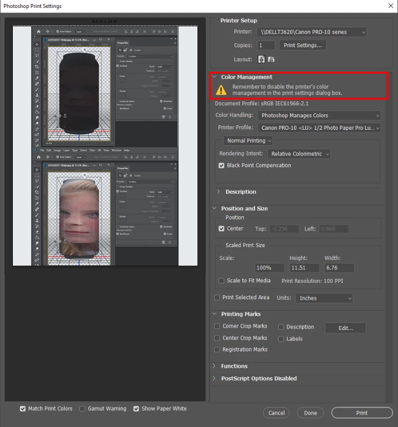

When I print something using my own profile or Epson profile using photshop controls color it looks bad.  It works when printer controls color.  Color mode is off and greyed out so I don't think its double profiling.  Please help Thank you

February 5, 2020
Did you remember to set the printers setting not to manager color. You do not want you images to be double profiled. Did you heed the warning in Photoshop Print dialog,
JJMack
alexuramAuthor
February 5, 2020
Yes, I am aware of that and checked it.  In fact when I choose Photoshop manages color  and choose my own profile or Epsons profile below the color mode box on the printer setting page says no color management and is greyed out.  I notice the only way I can toggle the "no color management / option is to set it to printer manges color in which case the options for Color Sync and Epson color controls become available.  If I choose Color Control and use my profile or Epson it wont let me print because it says mismatch. Does that make sense?
