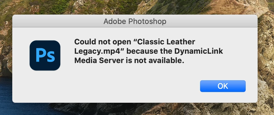

Anytime I try and open a video files with Photoshop, it could be an Mp4, Mov anything Photoshop gives me an error - it could not connect to the Dynamic Media Link Server. Photoshop sometimes buffers like its opening the file and nothing happends, I then have to force quite or I get the error message.
I have re-installed Photoshop and updated it but still the same thing, it actaully started after I installed a pluf in for After Effects, not sure if that can have naything to do with it but any info or advice would be mich appreciated.
Thanks 🙂

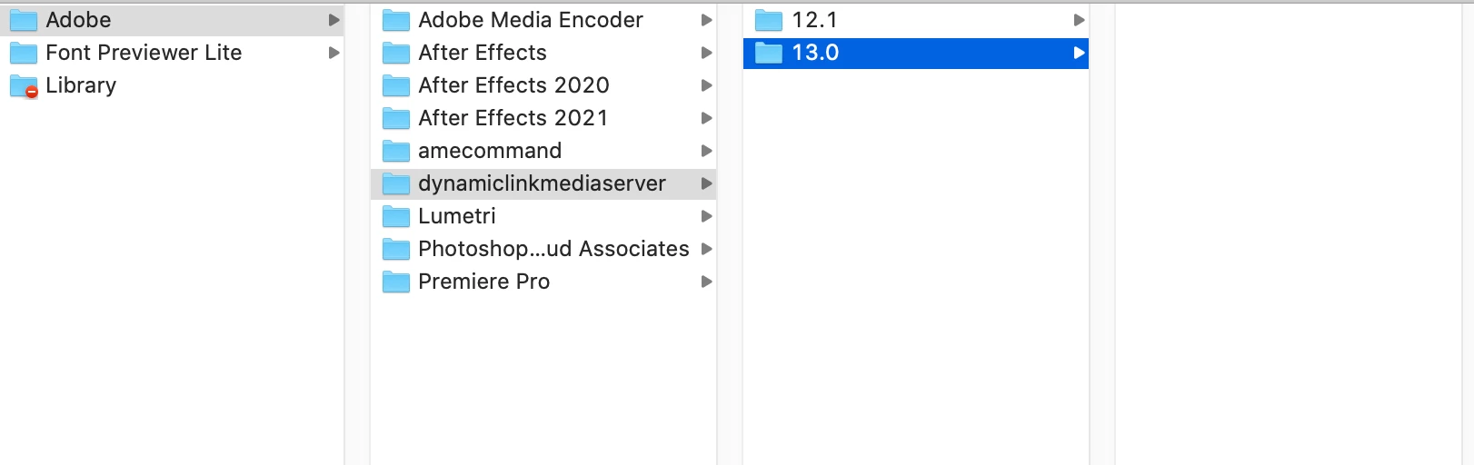

Hi, I noticed that the dynamic link media server folder is empty, is that folder meant to contain no files?
