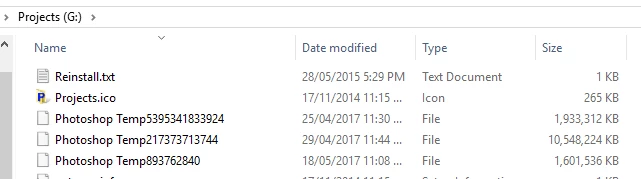

Check the root director of your primary Scratch drive.  If you have any Photoshop Temp********** that don't have today's date, then delete them.  As you can see, I just found two old files one of which is 10Gb!

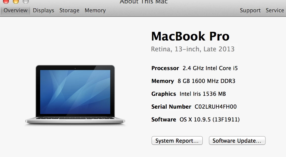

What operating system are you using?
How much space does your scratch drive have after you remove all Photoshop Temp files?
May 18, 2017
Thanks, I am operating on Mac

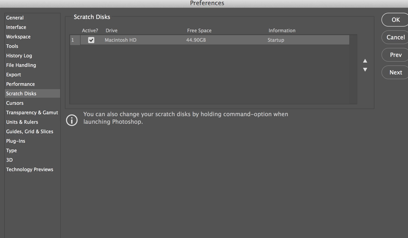

Here's my scratch disk:

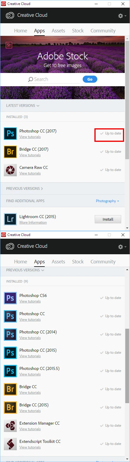

Does the Creative Cloud Desktop Application show there is and update for CC 2017 or does it show up to date?

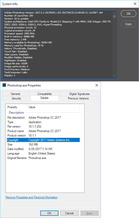

If up to date Photoshop System Info should show CC 2017.1.1

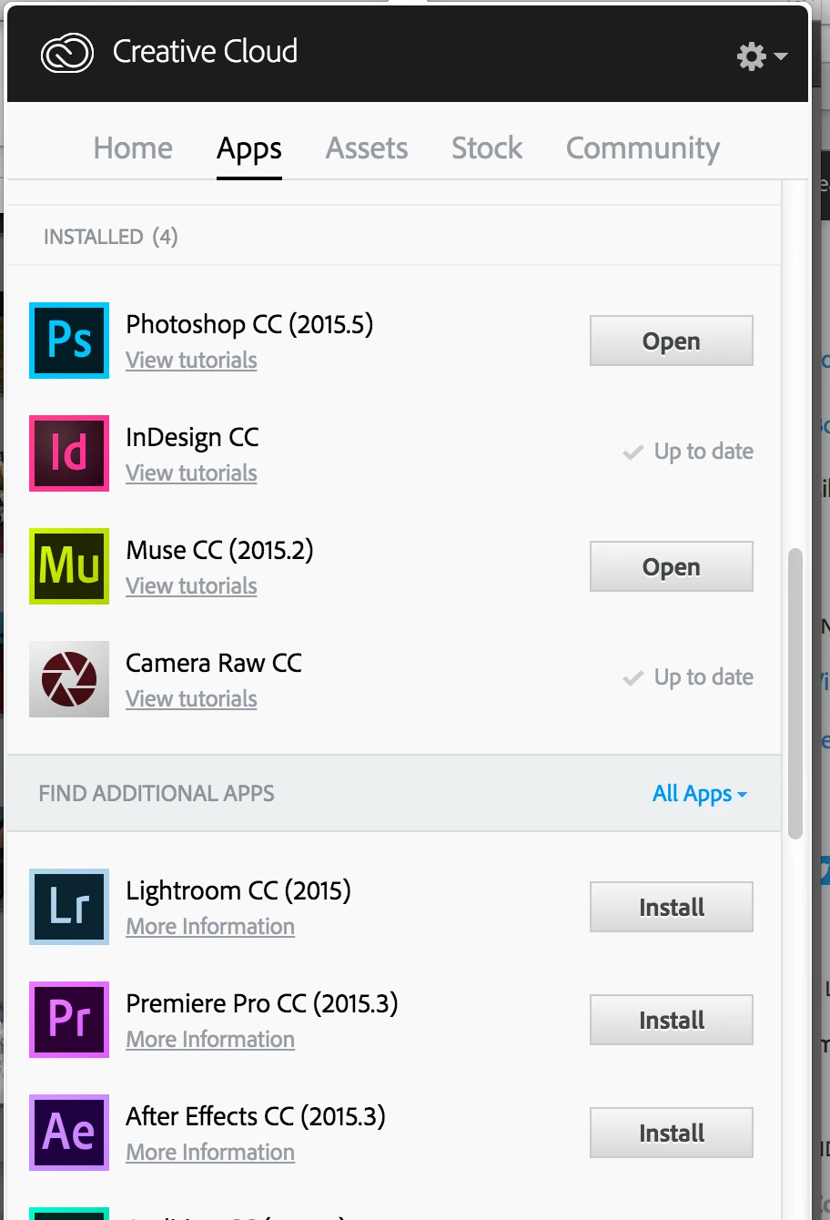

As you can see it just says version 15.5. It does not show me anywhere to update and I have had my CC look for updates multiple times.
Thanks for helping!
