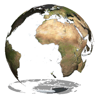

In that case you have two 3D layers.  You need to Select both Layer and merge that into a single 3d  Layer so they will bein the same 3d space.  here I merged a Sphere, a cylinder and a ring.  Sized positioned textured animated and saved and animated gif.
You can alsi use bump maps and opacity maps.
