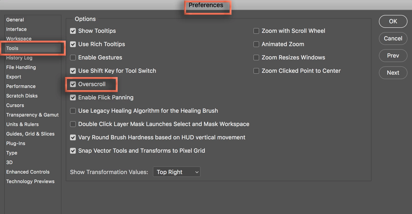

    Correct answer Barb Binder
    Go to Preferences > Tools > enable Overscroll.
    ~Barb

    Barb BinderCommunity ExpertCorrect answer
    February 4, 2018
    ~Barb
    PSUserRAAuthor
    February 6, 2018
    Thank you Barb, that does it.
