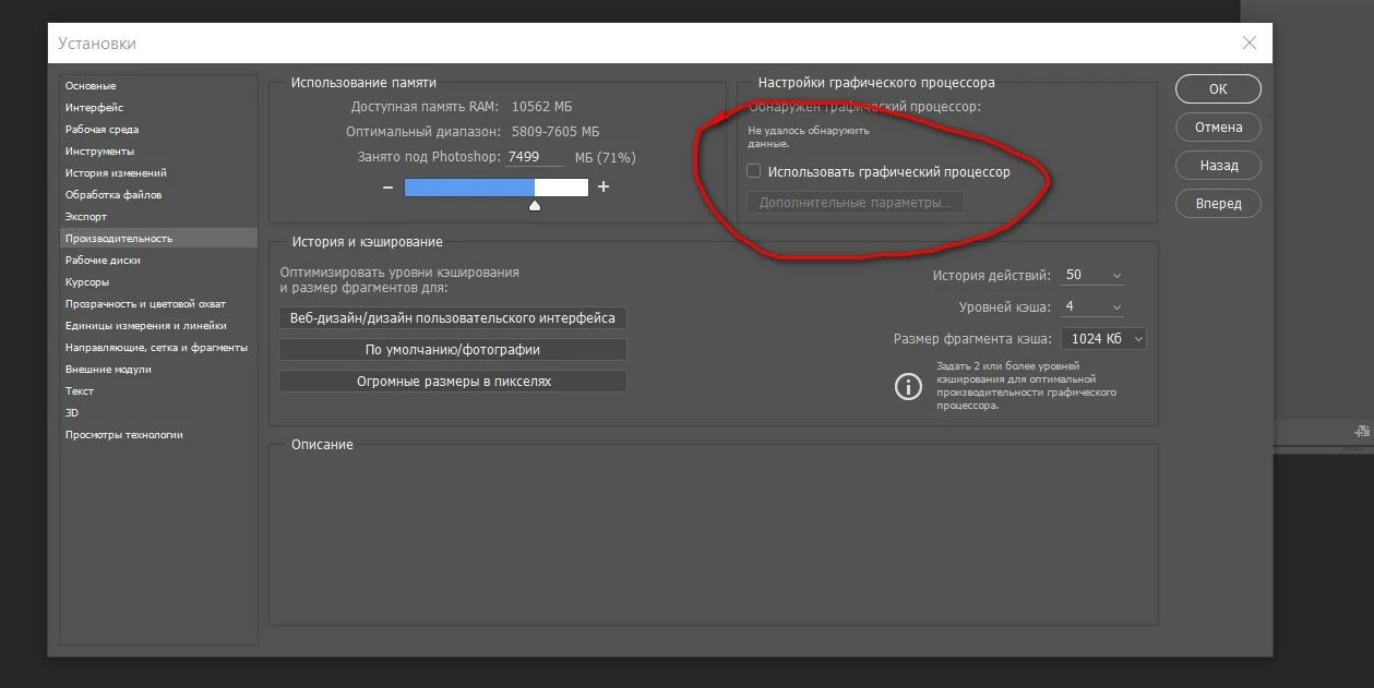

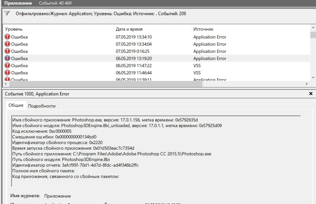

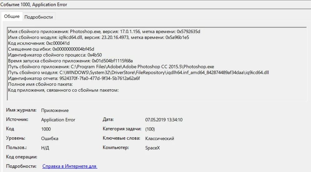

Have got two versions - CC-2019 & CC-2015. Both crash on closing the document or whatever action - so, random causes.
System: Intel Core I-5 (CabyLake) UHD 620, 16 Gb DDR4.
Problem with 3D-engine - some conflict on Graphics engine - check out the screenshots.
EazzyMFK
May 7, 2019
I have got Dell Inspiron 7573 notebook. Both Dell & Intel send me notifications on update - but in my case the problem is, that Dell's mainboard has one set of firmware drivers for chipset and UHD 620 - and Intell offers it's own set.
Recent update of video drivers from Dell causes conflict in Adobe's 3D engine somehow - Intel Online Hardware check says "refer to the manufacture"
Turning off == Use Graphic processor == on Photoshop settings STOPS crashing of the program permanently.
Though ain't resolving the initial bug - now at least I can use the Photoshop.
