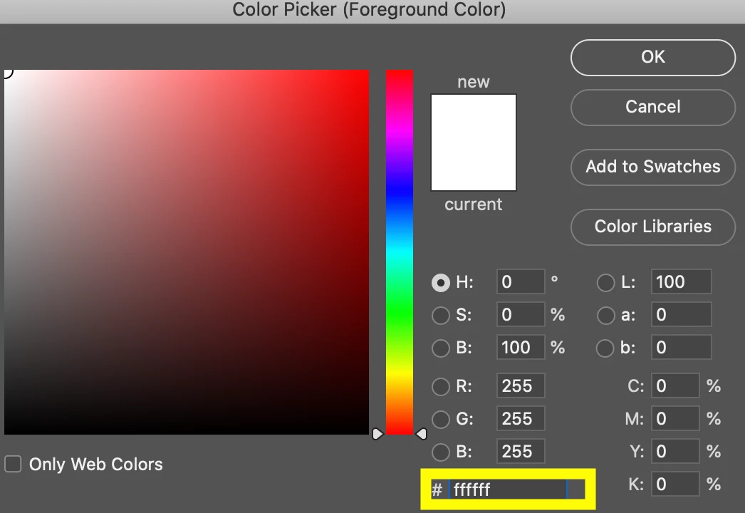

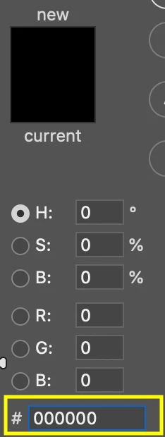

    Try this.
    Click the "Set foreground color" box.  Check the hex code (the box to the right of the '#' symbol).  For pure white, ensure the code is:   ffffff
    Additionally, to ensure the background is pure black, click "Set background color" box and ensure the hex code is:  000000

    When Jeff says "pure white and black",  click the "Set foreground color" box.  Check the hex code (the box to the right of the '#' symbol.  For pure white, ensure the code is:   ffffff      For pure black, ensure the code is:  000000

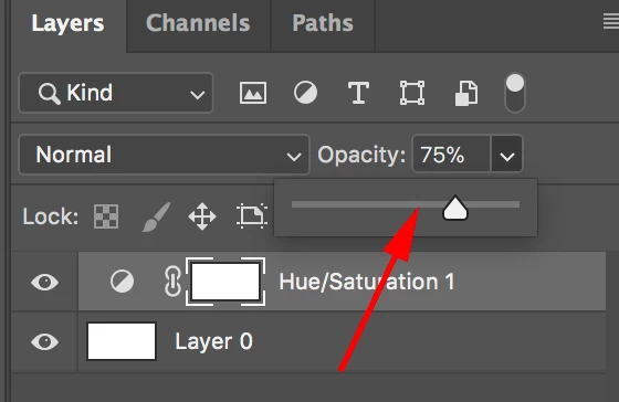

    August 1, 2019
    Are you certain the mask layer you are brushing into is set to 100% opacity?

    Jeff Bugbee
    August 1, 2019
    Can you make sure you are using a 100% white brush? Does your mask layer have an adjustment mode on it?
