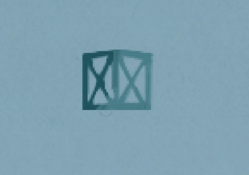

Hello, I'm having a similar issue when working, pixels keep moving on their own :

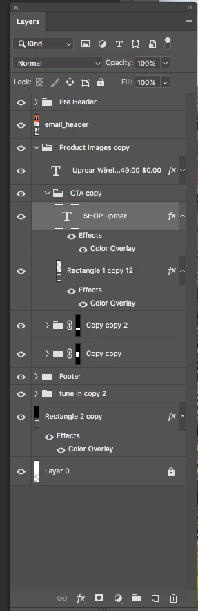

Before you worry about System info, can you paste a full screen, full res, screen shot showing the layers panel.  Try to  have the most relevant layer selected — that might not be straight forward depending on goodness knows what, but you'll know to make a good guess at it.
So Operating System, Screen shot, and maybe later, system info

Here's my layers:
You can see it's doing it to both copy layers...
