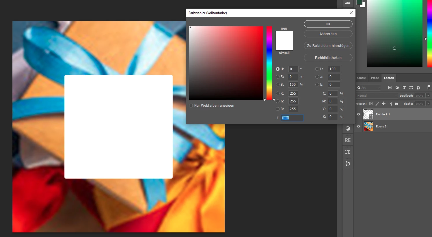

I have a layer which on which i add a conture effect and click on the color and want to sample a color from one of the underlying layers. I get the eyedropper mouse symbol but it won't sample any color. Reopened the same project in CC 2022 works fine. Is this a known bug oder is the color picker working differently in CC2023?
Thanks in Advance.

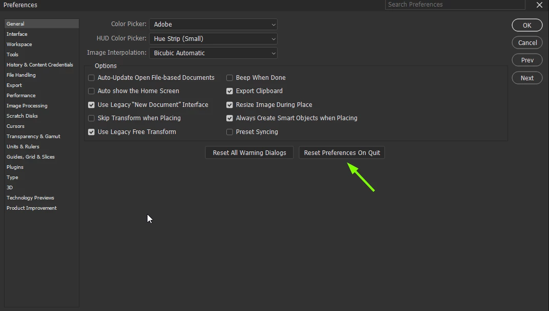

Maybe try a preference reset

can't seem to edit my post. It also happens, when i place a shape, double click it and try to use the color picker to pickup a color from the background. it doesn't pick up any color. Same PSD File works fine in Photoshop CC2022. I've attached a test PSD for that.

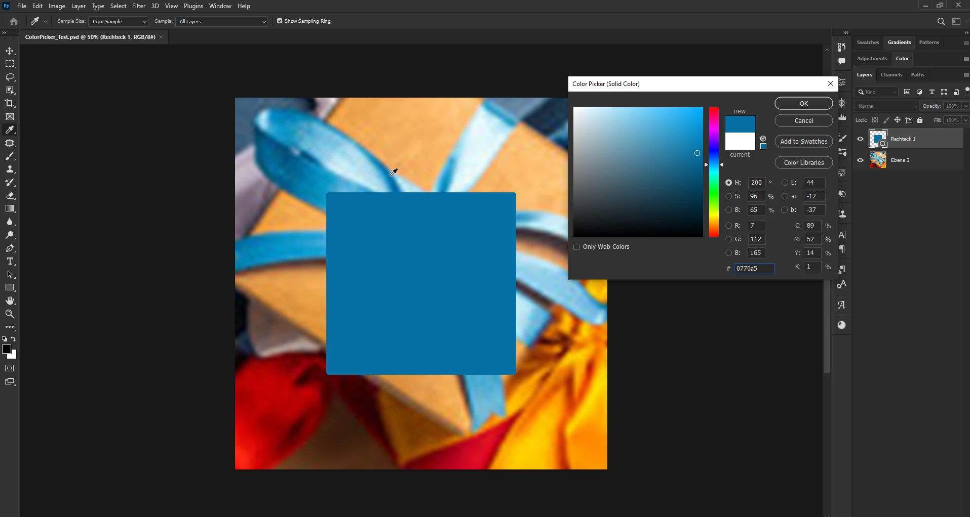

Thanks for testing it out. Really Strange. The eyedropper was set to 'Current and below' which should have worked, but didn't. I set it to 'all layers' and it worked, changed it back current and blow' and still works...strange. maybe it was stuck somehow and changing the properties fixed. Thanks for the suggestion to reset preferences. I would close this discussion (or even delete it) - if i could -  as it was kind of a dumb problem, sorry.
