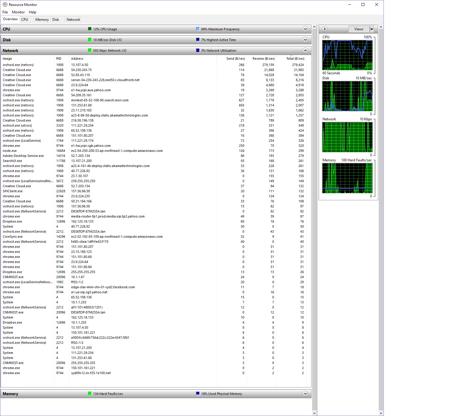

    Here is resource manager:

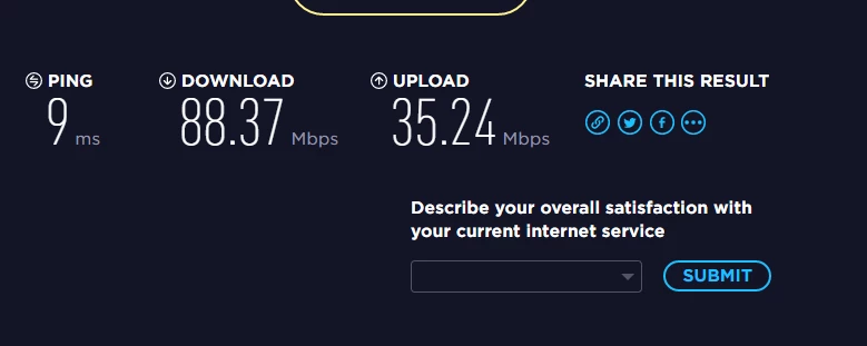

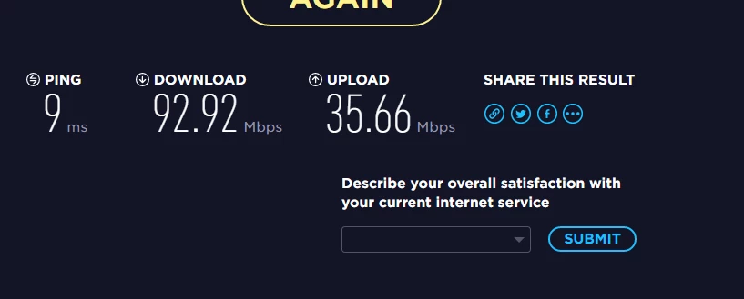

    I'm located in Australia, so this is the speedtest site I have always used.  First one is with Photoshop closed. Second is with Photoshop open in the background.  However, as I have stated previously, Photoshop can be open and the internet will be fine.  But the minute I click in the window and do anything, the lagging internet begins.  I attempted to do a speedtest while drawing with the brush tool but there was no real difference in speeds.
    And just to clarify, there are no templates/etc being downloaded.  File sync and font sync are off.  Libraries panel is closed.  While my knowledge of this stuff may not be great, I'm pretty sure there is no reason at all for this program to be accessing the internet (unless it was to update, but that is a manual process I would be aware of).

    thanks for doing those tests. From the results I can see nothing wrong with the network. Your broadband is slightly quicker with Photoshop open , but that's just some variation in the tester. Your download is 90 and upload 35 Mb/sec and when you took the capture the network was at 595Kbsec which is nothing.  The hard disk activity is high though at 18MB/sec so something is certainly going on in the background which isn't due to network/internet activity? Did you have anything running when you did the test?
    I appreciate your problem occurs when you are actually using Photoshop rather than when PS is idle which makes taking measurements difficult as you need to be running some kind of network analysis tool that creates a log while your doing something in Photoshop, but it doesn't look as if Photoshop is using the network when idle, so why should it start suddenly for no reason?.
    Am I correct in assuming that when you say the internet slows down you are judging on the basis of dropped frames in video on your browser as you do something in Photoshop? Try having Task Manager open on the CPU tab when running a video stream and actually using Photoshop with your Wacom tablet. As you draw glance at the CPU activity. Is it high? Photoshop can be very CPU demanding with certain brushes and a tablet working and on top of that you have Lazy Nezumi smoothing the brush strokes. If the CPU activity is high then the browser will have difficulty processing the video stream and drop frames, which will look like the internet speed has fallen. There are things you can try like reducing the amount of memory available to Photoshop and altering the CPU priority of Chrome from normal to realtime, but the truth is Photoshop is an app that works best in isolation due to it's demanding nature.

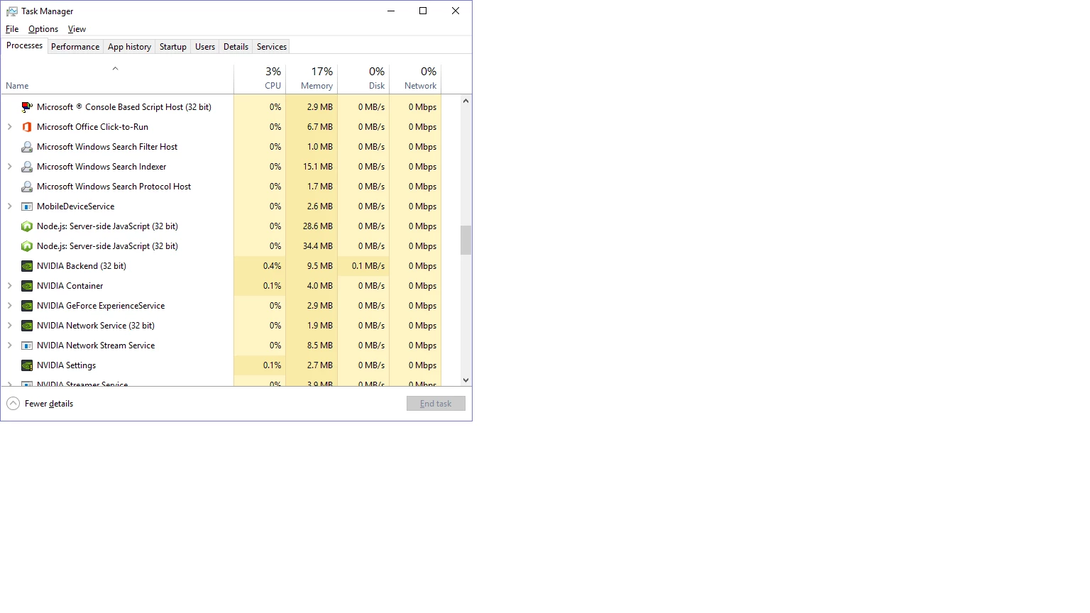

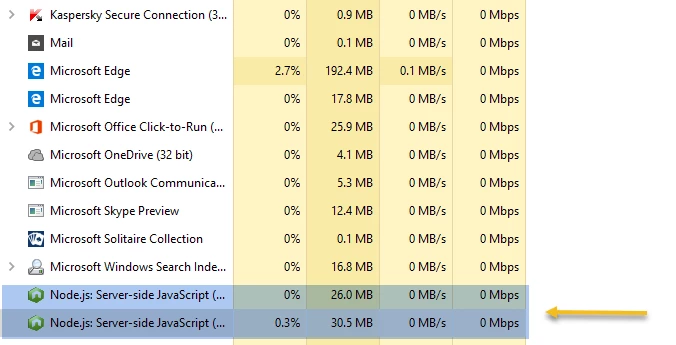

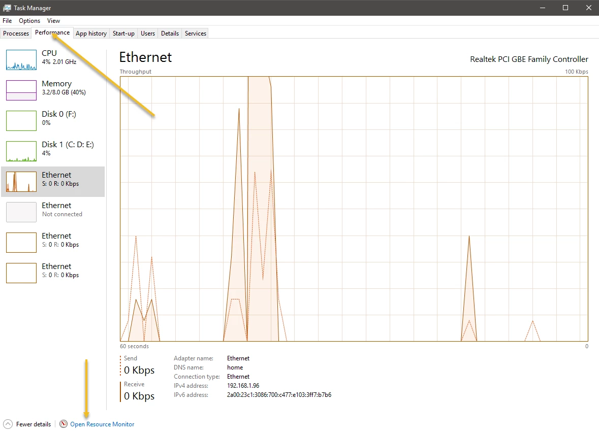

    looking at your thread here there are a few disparities. First you can't have 32 bit Photoshop as 32 bit became unavailable after CC was introduced. If you installed CS6, which is an option as it's part of your CC subscription, you would find two copies of Photoshop gets installed both 32 and 64 bit. However you are using PS2017 so it must be 64 bit. Not all components need to be 64 bit though and the CEPHTML processes is always 32bit. Looking at your Task Manager CEPHTML is using memory but not CPU or Network resources. I doubt very much if it is causing your problem. Your Task Manager in fact shows your network is activity is zero, so it's hard to see how Photoshop is slowing down your internet speed. In Task Manager pan further down the list until you come to Node.js:Server-side JavaScript and capture the screen. If Creative Cloud is using the network it will show up in the Network column on the far right column as shown below.
    The basic Task Manager is limited as it says nothing about what the network is doing. Instead let's use the Resource Monitor.

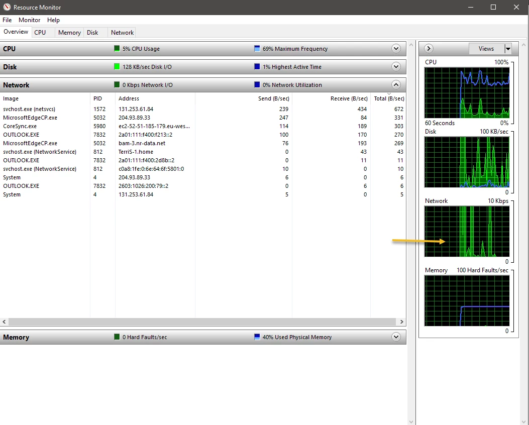

    In Task Manager click the performance tab, then click Open Resource Manager at the bottom. Don't worry if you don't have as many Ethernet options as I do-I have more than one network card in the machine here.
    Below is what you should see

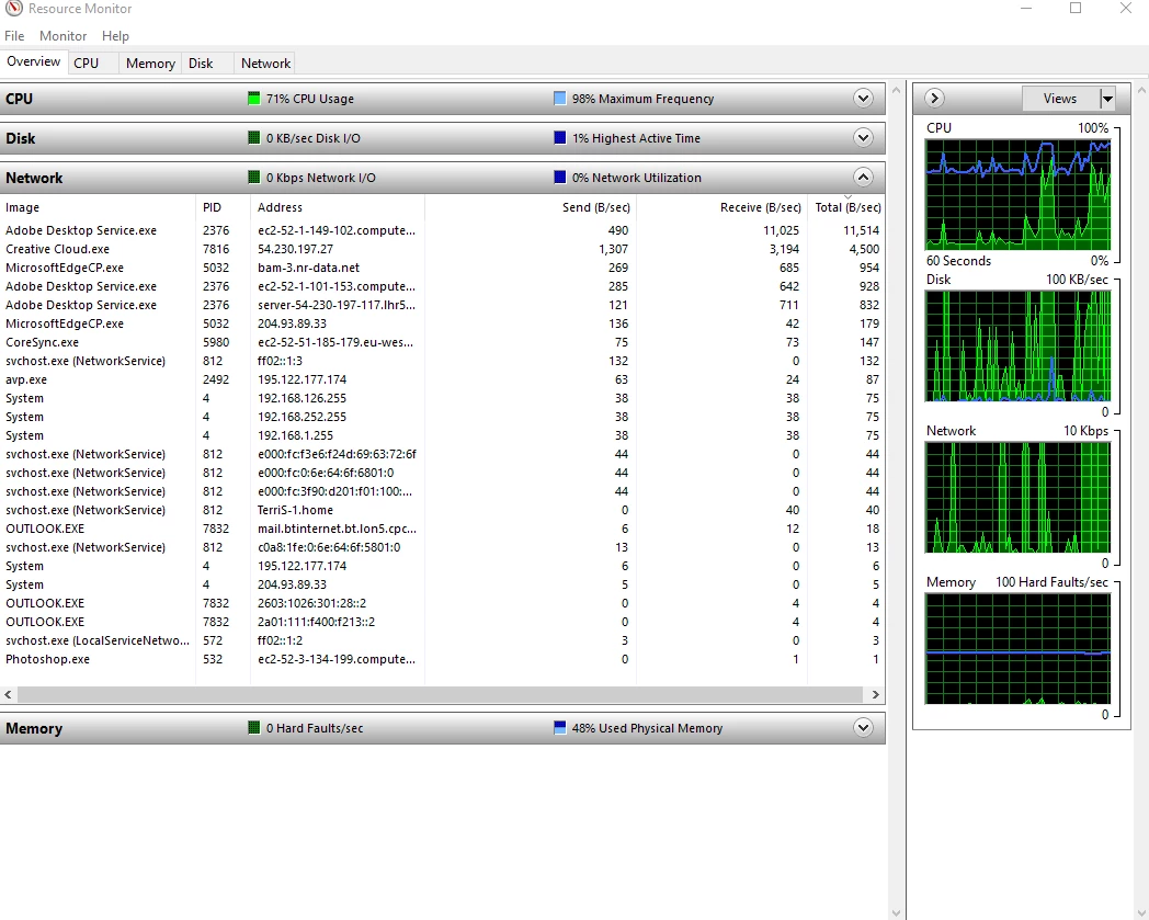

    You now can see the entire network and the apps that are using it , how much data is being sent , received and the total network activity per application. Below is the same thing with Creative Cloud running
    You can see at the top Adobe Desktop Service is receiving data as is Creative Cloud.exe and at the bottom Photoshop.exe itself. In this case the data transfer is tiny as my system is fully updated, but if you were to use a library or be downloading an update the values would be much higher. The Node.js:Server-side JavaScript process would also be there and very active. I think we need to see what your Resource Monitor is doing with regards to these processes to make sure your problem is actually Adobe related. It would also be useful if you did a speed test on your broadband. I'm in England and would recommend the following as it doesn't require any addons
