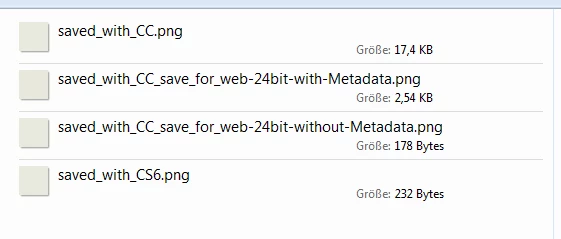

as a web-developer i'm working with PNG files alot. Since the release of Photoshop CC i always need to go back to CS6 for saving what i did in CC. I thought maybe it's just an early bug which will be fixed soon but still nothing and annoying. Maybe i missed something and there is a benefit in this bigger files? So here is a short discription...
When saving a PNG file
( file > save as > PNG > Compression: Smallest/Slow and Interlaced: None )
the files saved in Photoshop CC are about 17kb bigger compared to the saving in Photoshop CS6
A former 0,3kb PNG file gets saved with 17kb in Photoshop CC.
I use the English Windows 64bit Version of Photoshop CS6 and CC.
A fix would be very appreciated.
Screenshot of both files:
Bye!

"Save As" will save metadata in PNG (CS6 didn't write all the metadata it was supposed to).
SaveForWeb lets you control whether the metadata is added or not.

name2941Author
July 28, 2013
Stopped using "save for web" for PNG files a long time ago because of quality and transparency issues. I used "file > save as" instead. Maybe it's time to give "save for web" a new chance? I just saved a 24bit PNG file with it and didn't find anything wrong with the result. Also tried the Metadata controls resulting in even smaler file sizes compared to "save as" in Photoshop CS6... Do you think "save for web" in Photoshop CC and 24-bit results in (visibly) less image quality compared to the Photoshop CS6 "save as" dialog? And are there any know issues with transparency?
