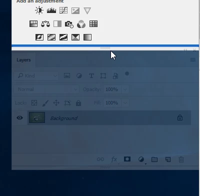

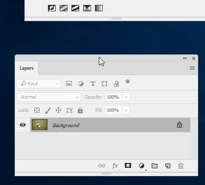

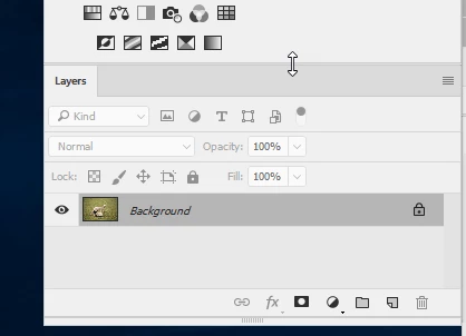

    Have you got your panels docked to each other?
    Drag a panel to the bottom edge of another until you see the highlight edge change - then release. That way expanding a panel moves the panel below downward.
    So :
    1. Drag
    2. See panel edge highlight (blue line below)
    3. release
    Once you have the panels the way you want them - Save the workspace
    Dave
