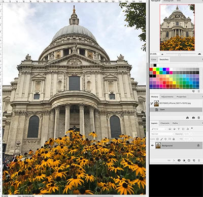

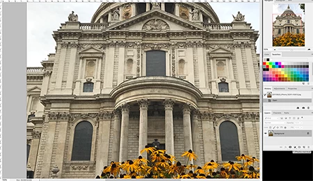

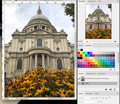

I'm having a problem with Photoshop CC's zoom behavior.
I have my preferences set so the window resizes When I zoom into and out of a photo, Photoshop CC includes the artboard beyond the photo's edges as it enlarges the window to fit what should be the zoomed-in image. I can click on Navigator and have the photo correctly fill the entire enlarged window space.
Same problem when zooming out: Click on the photo, the window resizes correctly, but a large unneeded section of the artboard shows up with the image. A click on Navigator fixes it. I've attached images of this behavior, if that helps.
It's a behavior I never had with CS5 (which I recently stopped using) and it's rather annoying. I've tried a variety of changes to the zoom preferences, but nothing's worked. Any advice about how to get Photoshop zoom top behave? Thanks in advance.
image at start

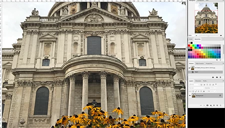

zoom in, window resizes properly but image not centered and artboard appears
one click on Navigator, image is properly zoomed and centered

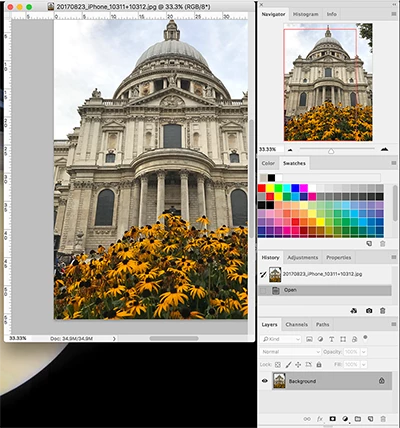

zoom out, again photo's not centered, artboard appears
again, one click on Navigator, image is properly zoomed out and centered

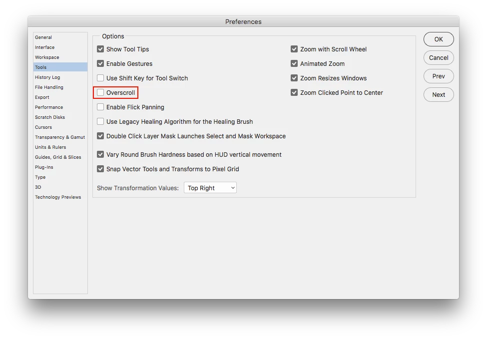

    Correct answer Jeff Arola
    If you go to Photoshop CC>Preferences>Tools, do you have Overscroll checked?
    If so, uncheck Overscroll and see if the zooming works any better.
    Jeff Arola
    October 2, 2017
    DHStudioAuthor
    October 3, 2017
    Looks like that's the correct answer, tried it with a couple of photos and it works so far. Thanks!

    OK, perhaps they weren't called artboards — thought I'd use the same term Illustrator uses for clarity — but when I zoomed in CS5, it only zoomed on the image and showed as much as possible within the window, no "artboard" at all. CC, meanwhile, seems to include a lot of the artboard and ignores centering it within the window, which seems like a waste of time. (Unlike with Illustrator, I've never used the space beyond the image in Photoshop.)

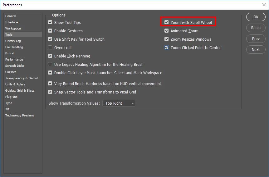

    JJMack
    October 2, 2017
    Versions of Photoshop before CC 2015 do not have artboards.  You do not have to use Artboards in your CC documents.
    Try setting your CC Preferences to zoom with mouse wheel and see if that zooming will help you out some.

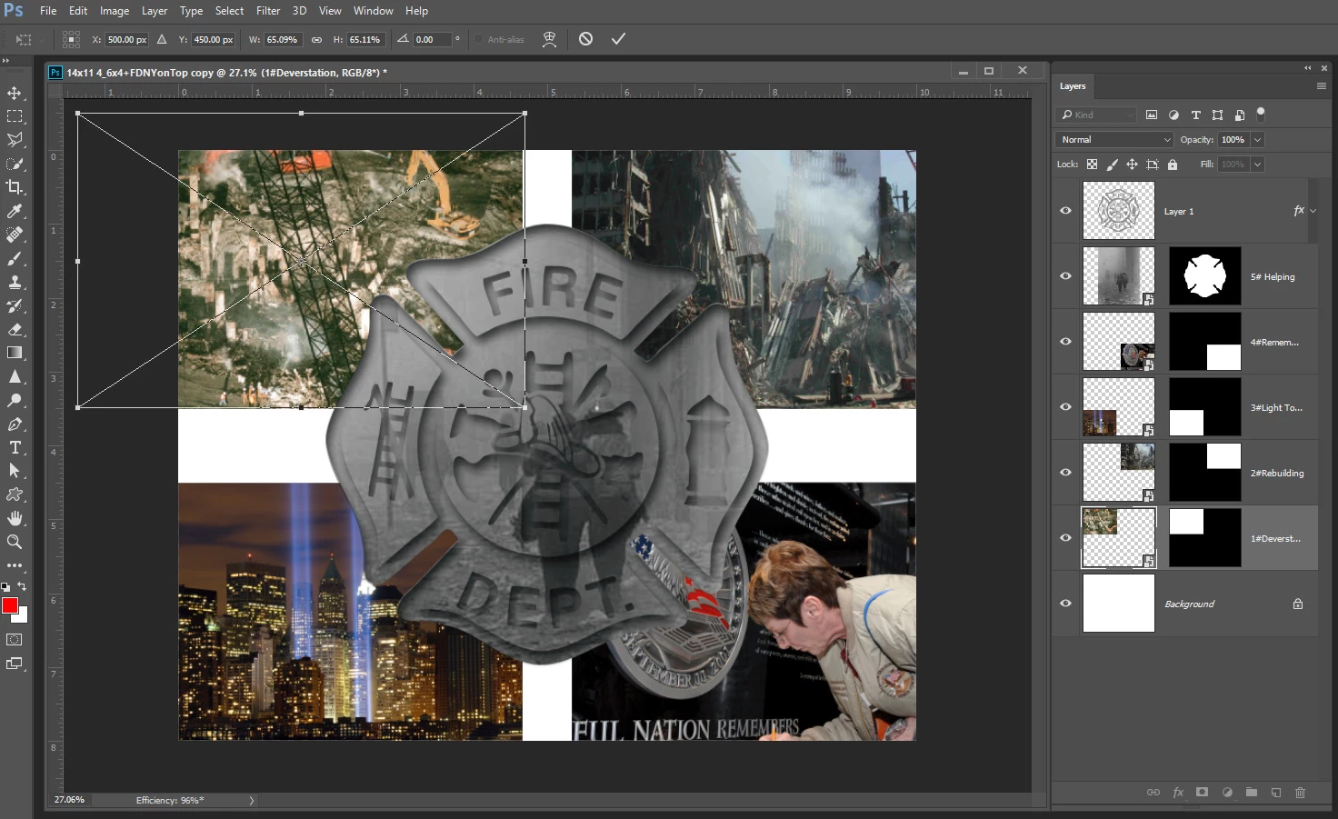

    Also all version of Photoshop support any size layer layers can extent beyond the document canvas I find there are times I need to extend the image window to show area outside the document canvas so I can transform layers.
