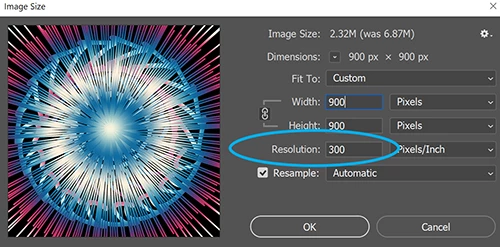

Use File > Export > Export As >  JPG.  See screenshot.
Close it out.
Re-open and check Image > Image Size.

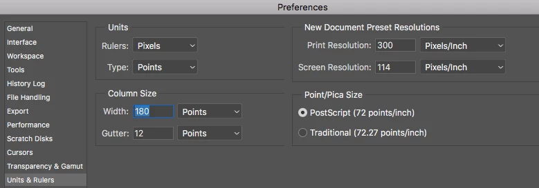

Cmd k to go into Photoshop Preferences. What is the Print Resolution dpi?
kippycube
kippycubeAuthor
May 19, 2019
My print resolution is 300 there as well.
