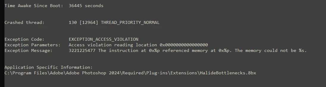

December 19, 2023
Hi! I have used the cleaner tool and installed a fresh copy of Photoshop. It still unpredictably crashes without warning.
I've checked the log and found this, it points to HalideBottlenecks.8bx. The exception code sounds like a memory issue but this problem has never occured on all versions of Photoshop before I switched to Windows 11. Windows Memory Diagnostic shows no problems, however I've yet to try MemTest86.
