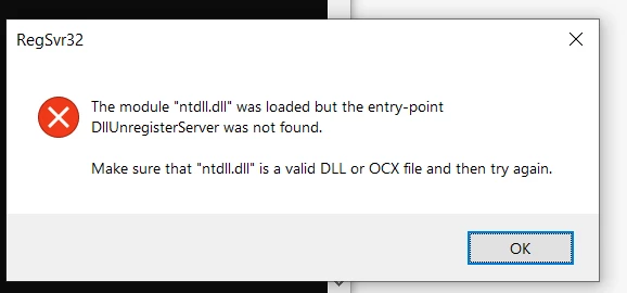

Hi Ged. I've tried this before but had another go after all the re-installation.The first option results in this
Could this be the problem? And if so, how do I fix it?
The second one - I've scanned the system twice in the past 24 hours (once with Microsoft Support mid-chat) and no issues found.
I've also done something called a DCIM which also found nothing.
