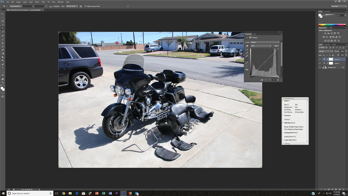

I am and have been using Photoshop CS6 (64 bit) for the past few years with no problems. Recently while editing my photos (The process I use follows these 3 steps.  1- Adjust Levels; 2 - Adjust Curves; 3 - Adjust Hue/Saturation) I get a strange problem.
Step 1 (Levels) works fine and causes no issues
Step 2 (Curves) is where the issue occurs. I select "Curves" via the Create new fill or adjustment layer icon located in the lower right of the screen and another Levels adjustment box pops up, but no Curves. Hue/saturation works fine. Once in a while I am able to get the Curves box to show up, but the histogram has vertical lines thru it.
I was going to uninstall and then reinstall Photoshop, but I cannot seem to find my disk
Any help would be greatly appreciated

    c.pfaffenbichler
    March 6, 2018
    Looks like the regular Curves display to me.
    c.pfaffenbichler
    March 6, 2018
    What have you done for trouble-shooting so far?
    Restoring Preferences after making sure all customized presets like Actions, Patterns, Brushes etc. have been saved might be a good starting point:
    https://helpx.adobe.com/photoshop/kb/basic-trouble-shooting-steps.html
    Could you please post screenshots the pertinent Panels (Layers, Channels, Properties, Options Bar, …) and dialogs visible?
