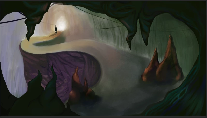

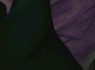

I am having the same issue! Just started today, with the brushes I am using I have never had this issue. I have tried resetting my prefs, I have tried resetting my tool presets. It's just not flying, and it's quite unfortunate as this is a project for my class which is due Monday. I have a shot of my project, we are focusing on the green. In the top left to right, and right bottom corner are BEFORE the issue started. I am pulling from the same palettes, using the SAME brush. The bottom left green spikes are where the banding occurred. Did use a shade of teal over the green, to show that. It's usually much smoother and blends far better than what we see. That's with the opacity turned down aswell. If you need better pictures, let me know.
