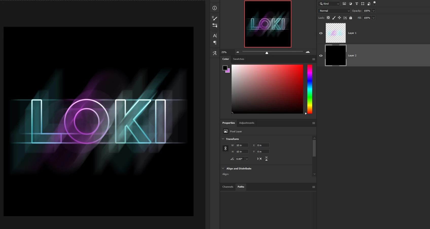

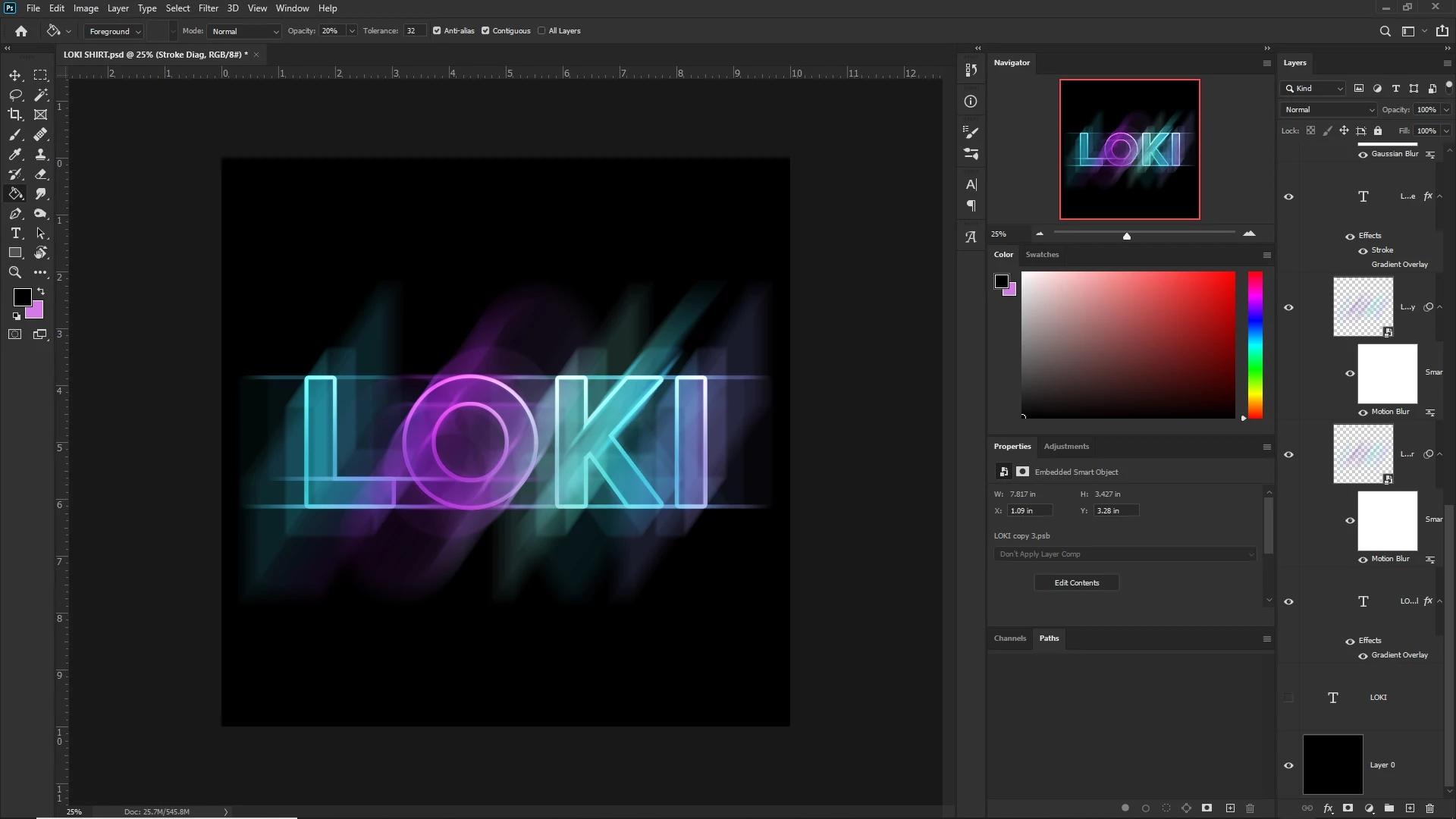

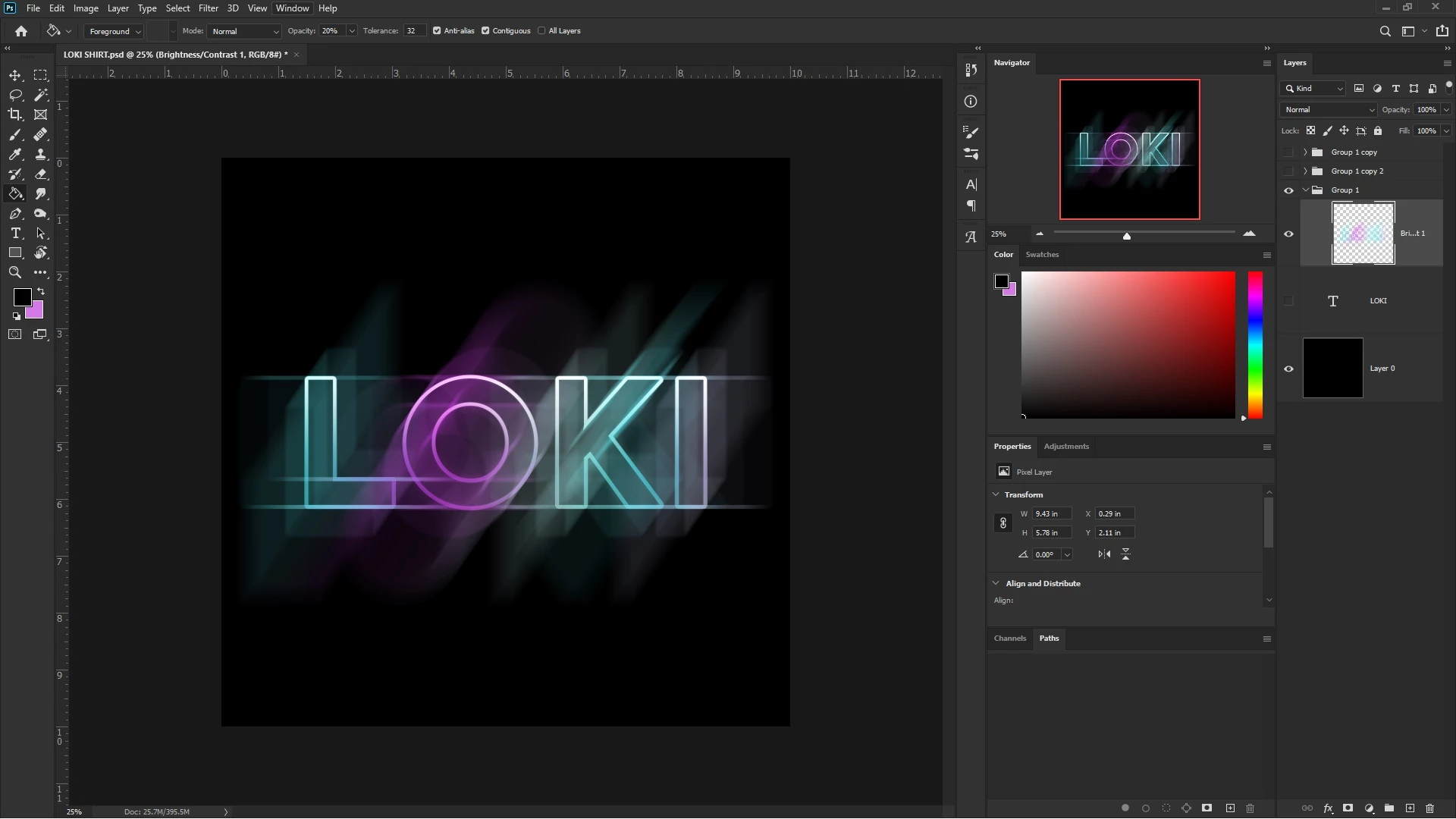

The first image is how I want it to look. The 2nd is how it turns out upon export. I was able to recreate that by merging all the layers. The 3rd is me assigning the adjustment layer to the group using the alt-key method, but it still fades the colours. This problem occurs in both PS2019 & PS2020.

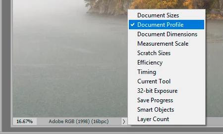

OK, we need to get this out of the way first, because you don't understand: When you Export, it's a new file. It's not the same file anymore. It may have a different color profile, but most likely it doesn't have a profile at all, because Export strips the profile by default.
So already here we have a lot of variables. This isn't trivial. This is important! Don't brush it off. Here's how you check the profile:
Anyway. If you have confirmed that all three are indeed sRGB, and all have that sRGB profile embedded, then we can move on.

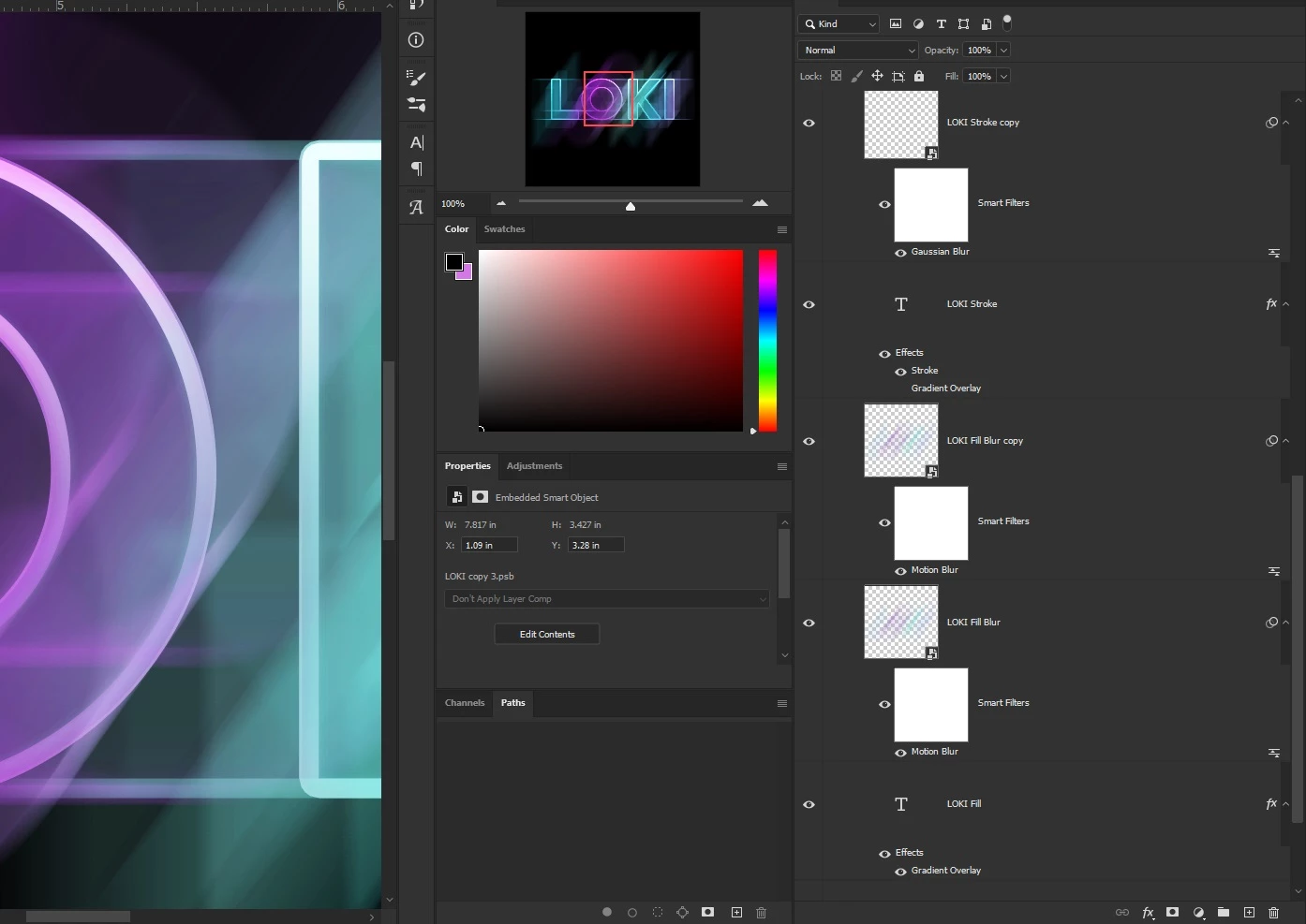

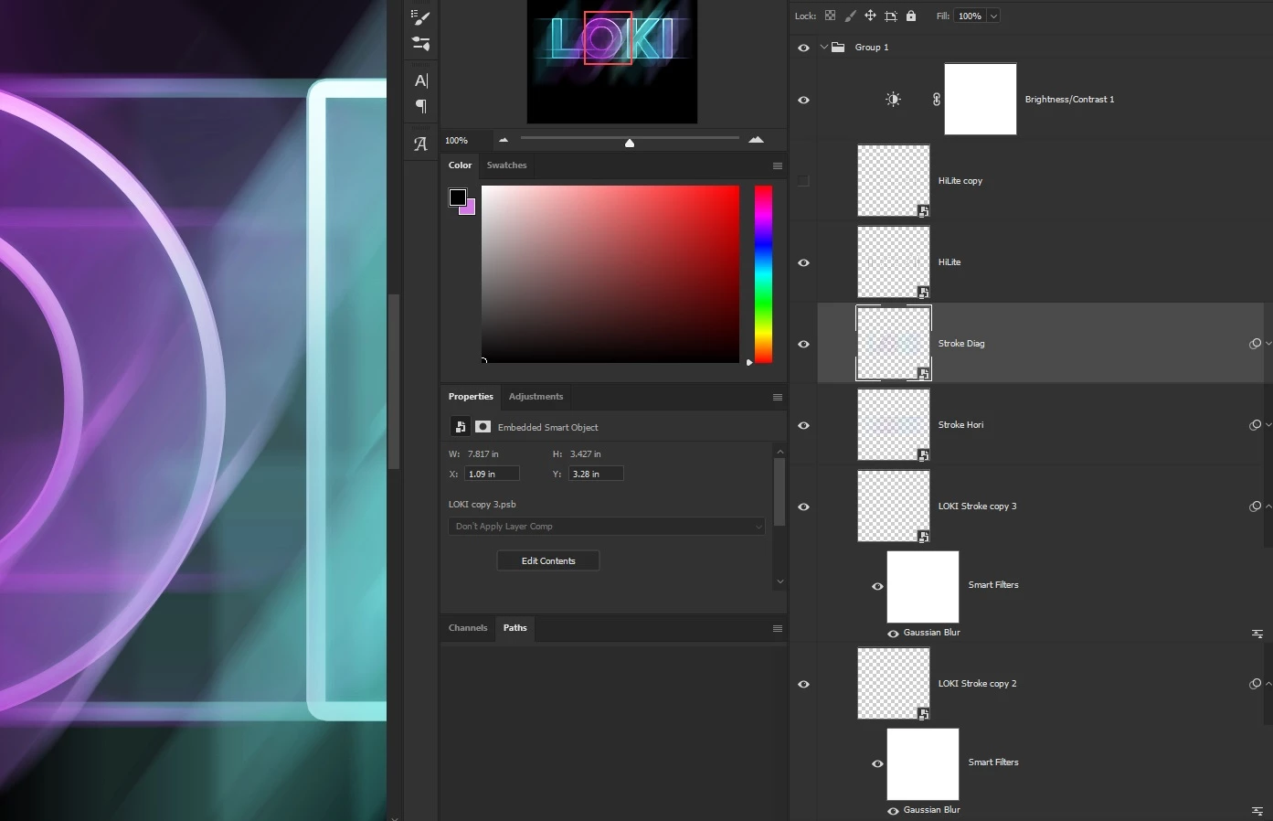

I've attached a close up of all the layers on the main PSD. Hopefully they show at your end.
As an extra, the last screenshot is the PNG on a black background after being reimported into Photoshop.

What is the color profile of your original? Exporting changes the profile to sRGB rather than Adobe RGB 1998 or some other higher gammut profile.

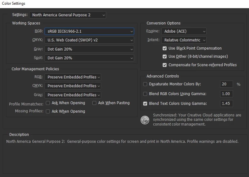

But for what it's worth, here's the colour profile.

"I doubt the colour profile is the issue. All 3 screenshots are from within the software."
Every file has its own color profile, independent from each other. The embedded profile will always override your working space. So yes, you can have three files open and each is color managed differently.
If you don't make sure to embed the profile, you're throwing another wrench into the machine. In that case the result is completely unpredictable. The profile must always be embedded.
For some mysterious reason, Export does not embed the profile at default settings. You need to check the box to embed the profile, and to make matters worse, it doesn't stick. You have to do it every time.
So, once again: What are the color profiles of your three examples? Don't make any assumptions. Check.
