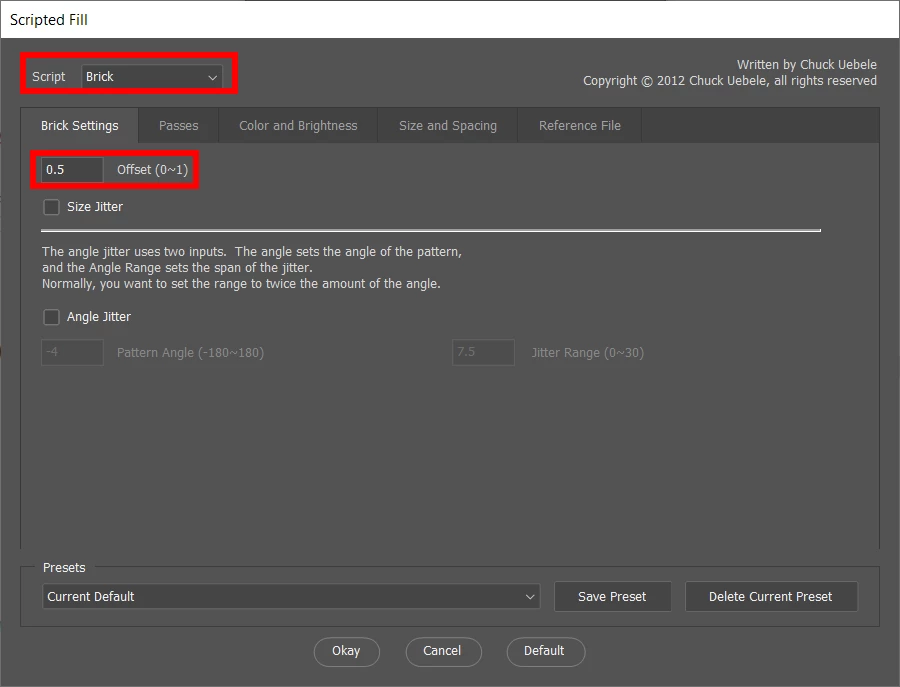

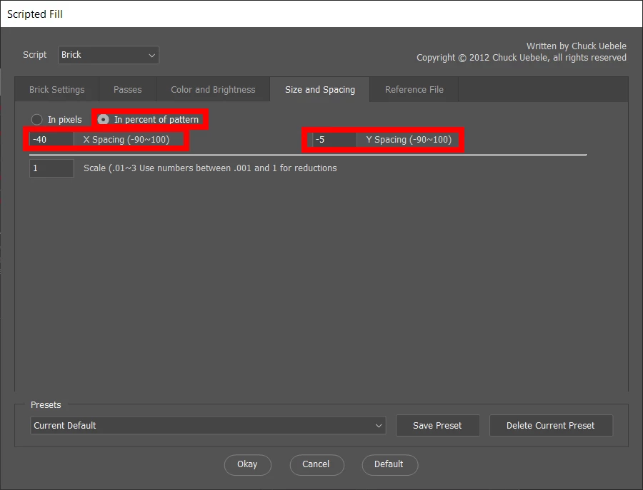

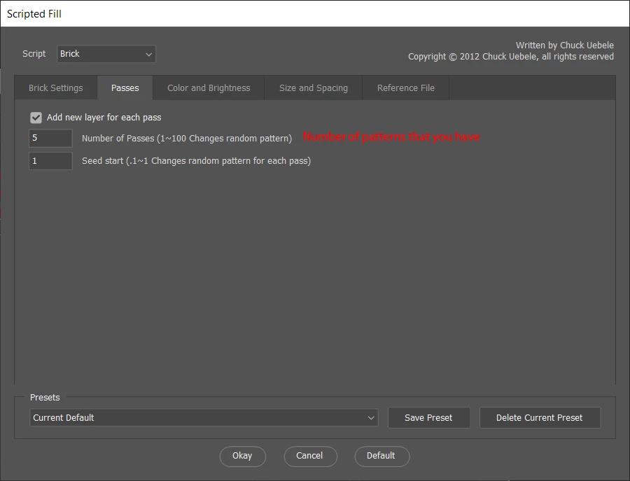

    You can use the scripted fill with a script that I wrote, which is available Here: Scripted Fill UI - Photoshop CS6

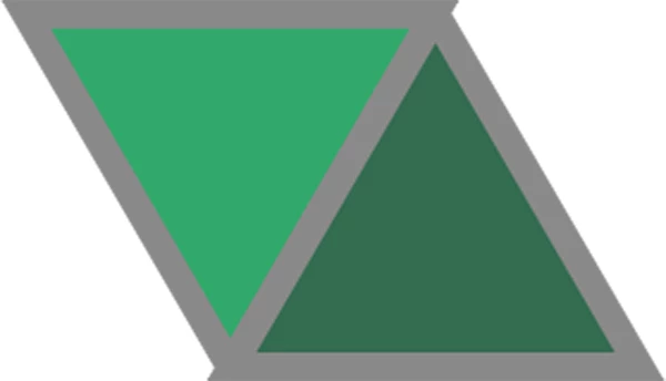

    By creating different colored patters like this:
    You can use my script to change the selection of the pattern to each of the different patters. There are setting you have to do do make them line up:

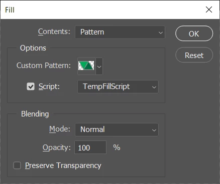

    Use TempFillScript as the script. Once you click the okay button on my UI, the standard UI will show up the number of times that you selected for different patterns.
