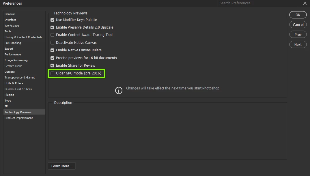

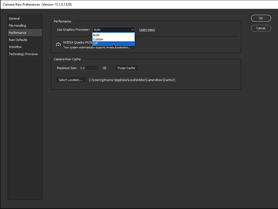

You don't have a dedicated GPU, also the GPU driver in more than 18 months old, you can update it via this link https://www.intel.com/content/www/us/en/download-center/home.html
You can try enabling this option in preferences and restarting PS to see if it helps, also try disabling the GPU in the ACR preferences
ACR
