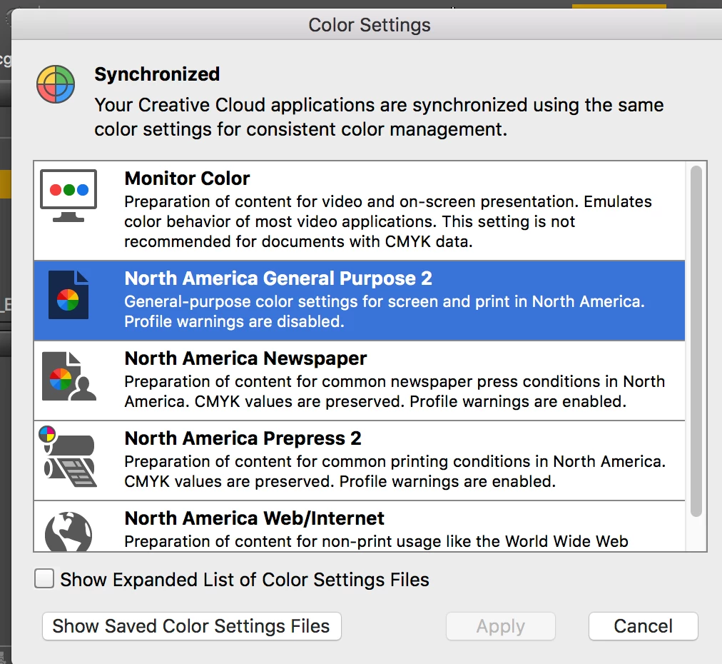

    One thing to note is Bridge Syncing changes your Photoshop Color Settings, which are applied to future documents.

    To start off right I would go to  bridge edit >> Color settings, and make sure you are synchonized.

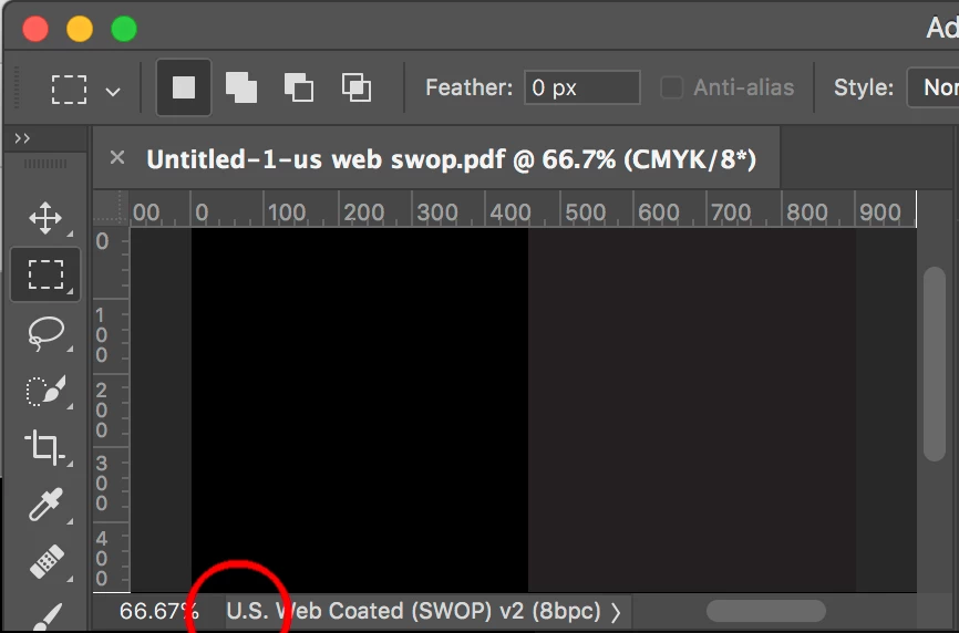

    My file has photoshops default foreground color on left, and 100k on right. Note my assigned color profile shows on bottom left.

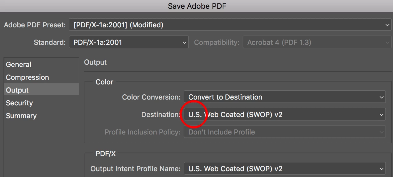

    Next I save as .pdf and change the color profile to match what I will be using for simulation profile in Acrobat. (matched  closest I had to yours). I had to modify PDF/X 1a  destination profile to US Web Coated SWOP 2.

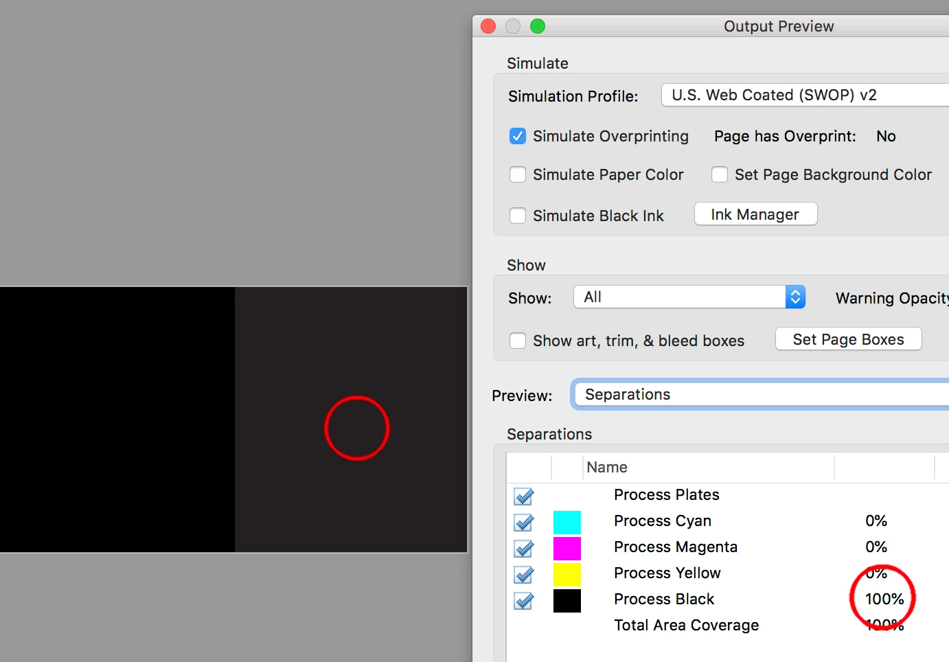

    Then in Acrobat the profile you saved with is what acrobat should choose by default. My cursor is over right side square (screencap on mac does not capture cursor) so you can see I got 100k.
    If anything is not perfect then you will get  values you describe. So I took alot of screenshots and hope this helps as my guess is your destination profile is not matching your simulation profile.
