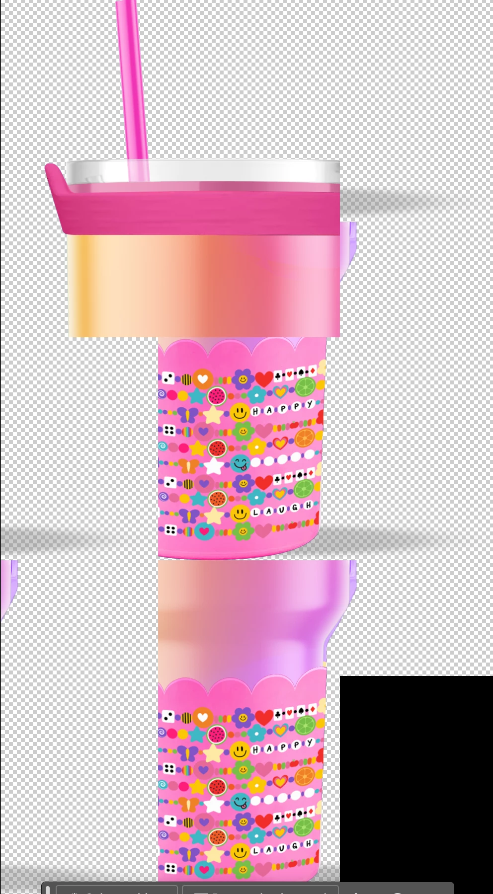

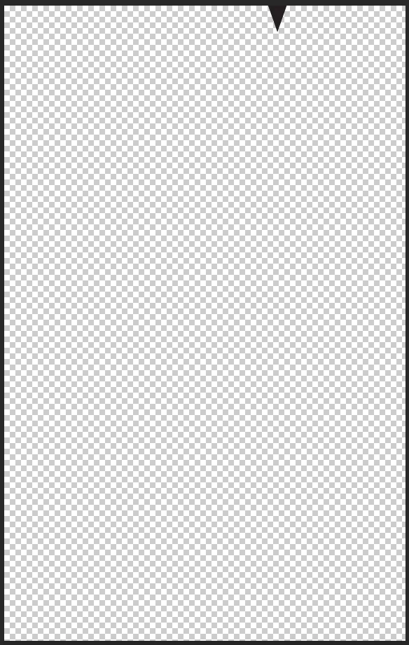

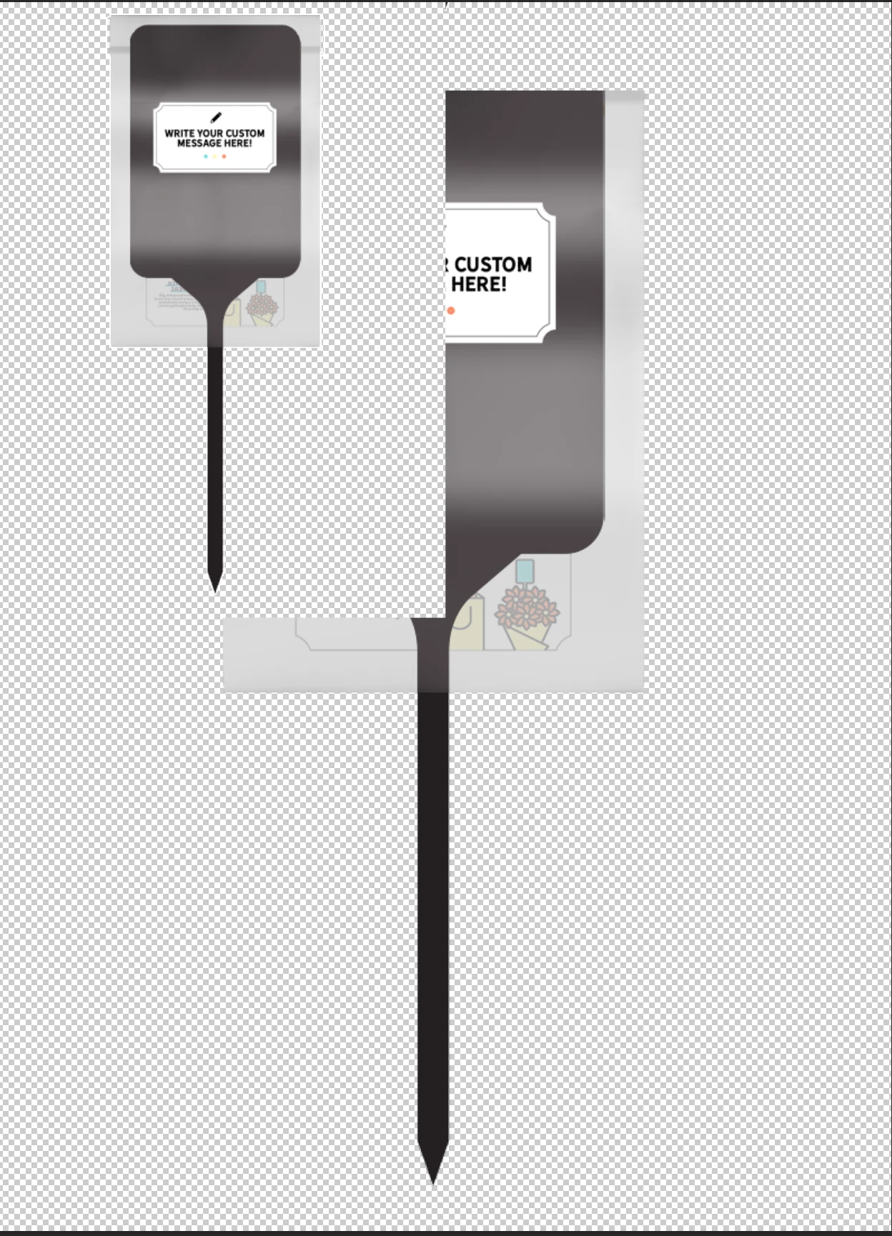

My files are rendering glitchy since I updated my Photoshop (I was previously using 2023 without any issues). Now I'll get random artifacts on my artboard, double images, and smart objects just not displaying at times. Sometimes scrolling will sort of "reset" how my file looks, but since updating I just can't get some files to display properly at all. I work with a lot of bigger files with many smart objects embedded in them and it's frustrating that this is a problem now. I tried going a version down from 25.4, but the problem still persisted in 25.3.1. I even tried turning off multithreading in the performance settings and it's still acting up. I haven't tried downgrading back to 2023 yet, but the fact that this is happening is such a bummer. Any ideas on what could be causing this? Thanks so much in advance.
Edit: I downgraded my photoshop to 24.7.2 and these rendering issues went away. I'm still wondering how to handle the performance in newer versions though.

Hey, @Shelilah. Thanks for sharing the details about the issue. I'll help you figure this out.
Does this happen with almost all kinds of documents you work with? Does this appear with the documents you create now?
As a test, try using Photoshop (beta) and check if that helps to some extent. Also, try this in Photoshop > Settings > Performance > Advanced Settings > 'GPU Compositing' & restart Photoshop & check if it helps.
Let me know how it goes. Thanks!
