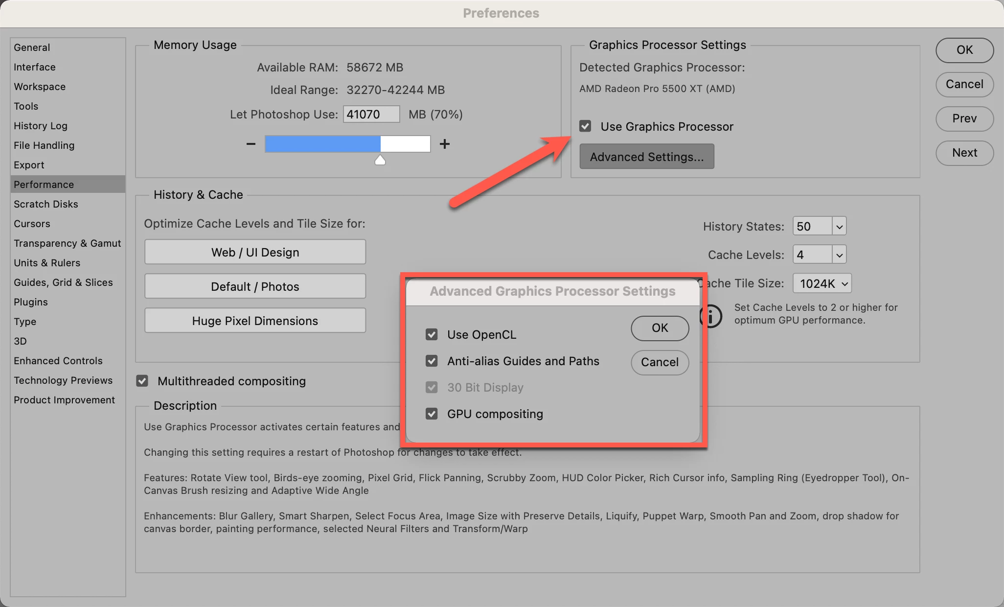

Hi. This is a user to user forum, and it's occasional that any Adobe employees will attend these posts.
Has this been happening since you updated PS, or did it start some time afterward? Your GPU is plenty for Photoshop.
If this happened since the date of update, I recommend using the Adobe Cleaner Tool and then reinstalling an older version of PS, while reporting this to the Bug Reports section of this forum (tabs on the top of the forum). Also, simply a clean installation with the Cleaner tool will often remedy the situation.
I'd be curious to know if this occurs when you turn off GPU in Photoshop>Preferences>Performance- or when you try altering any of the Advanced GPU settings.

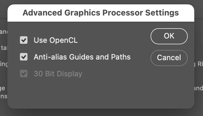

When I change anything in advanced graphics settings nothing changes. Even after restarting PH.
I have a different window regarding to yours. Does that matter?

Adobe removed the GPU Compositing option in version 23.4.1, so I would assume S_Gans screenshot is from an older version
