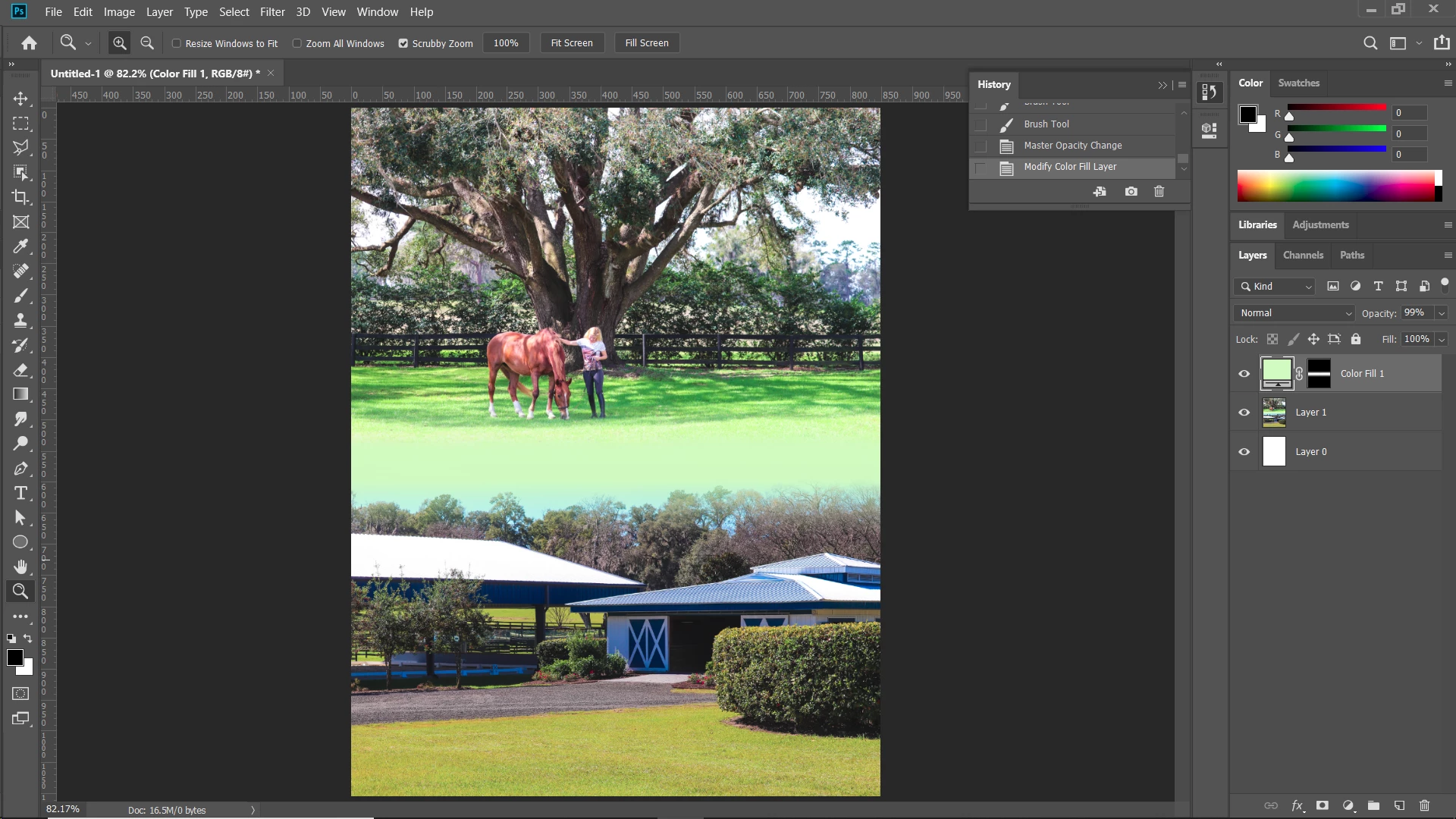

Hi I am new to photography as well as photoshop. I am finding it fun and useful. I am trying to help a friend create and advertisement using 2 photos I took. The problem I am having is creating a seamless connection between the 2 photos.
I would like the one photo (tree's) to be on top, and the second photo (barn) to be on the bottom. I have 2 different ideas I am working with.
The 1st is to create a white fade between the two photos where I can then put the name of her farm, and her moto. The problem I am having is getting the fade in the correct location and for it to go both ways up and down. I get the desired look but you see the line between the photo or the white is not strong enough.
the 2nd idea is to use the auto blend option. What I like about this is, when I used it, it dose make it appear that the two photos are seamlessly connected to each other the sky in the bottom photo (barn) disappears and the grass from the top photo (tree) blends down. Where I have an issue is using this function completely messes with the colors on both phots making them look drab and not vibrant.

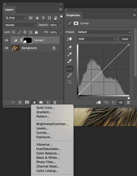

    Hi
    Put a curve adjustment layer directly above the layer you want it to affect in the layers panel. Then, again in the layers panel, Alt click on the border between the image and adjustment layer. A small down arrow will appear and the adjustment will be clipped to that layer I.e. the adjustments will only affect that layer.
    Dave

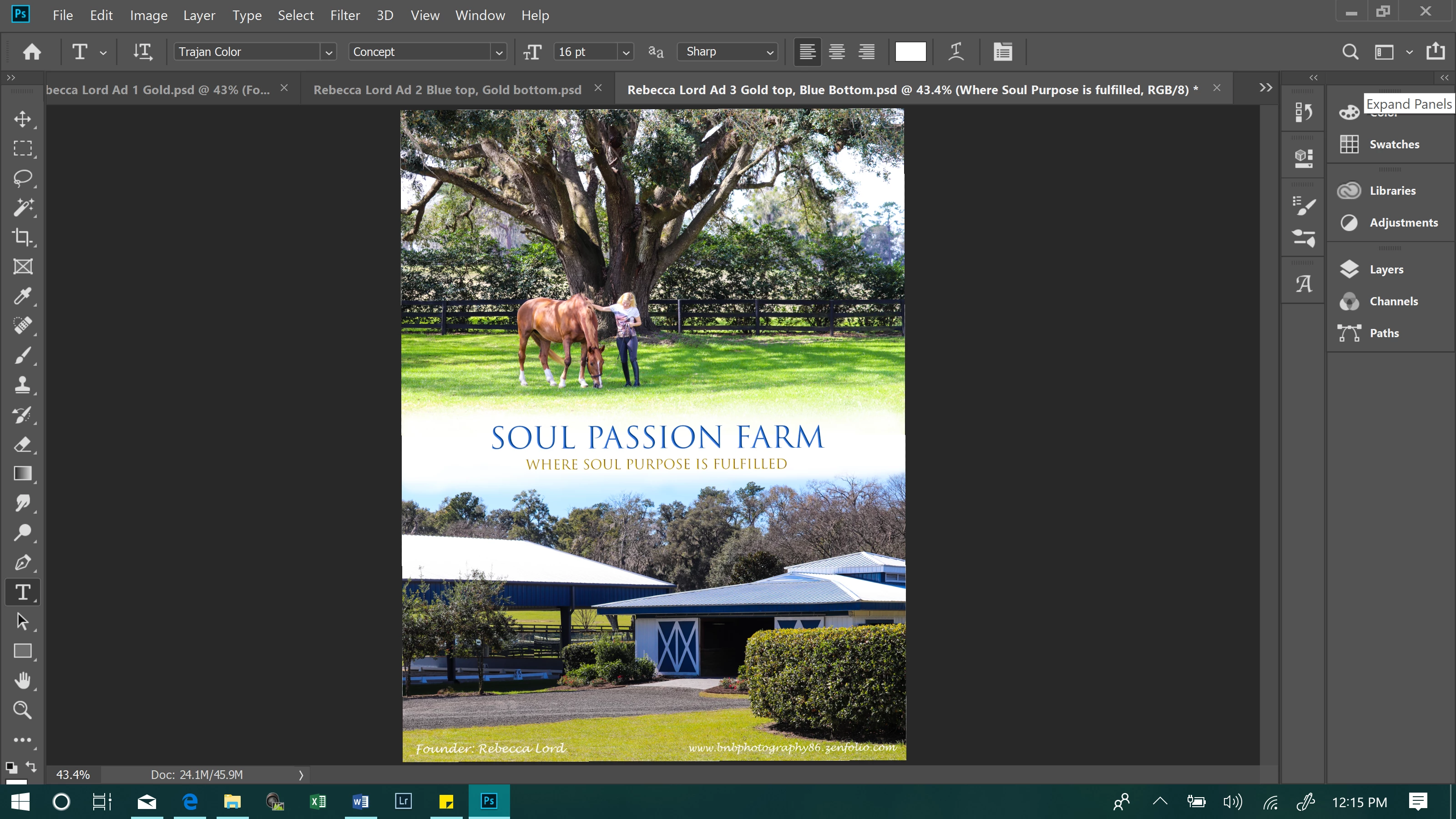

    Thank you all for your help.
    The client/Friend is happy with what we ended up coming up with. But this has led me to a separate questions.

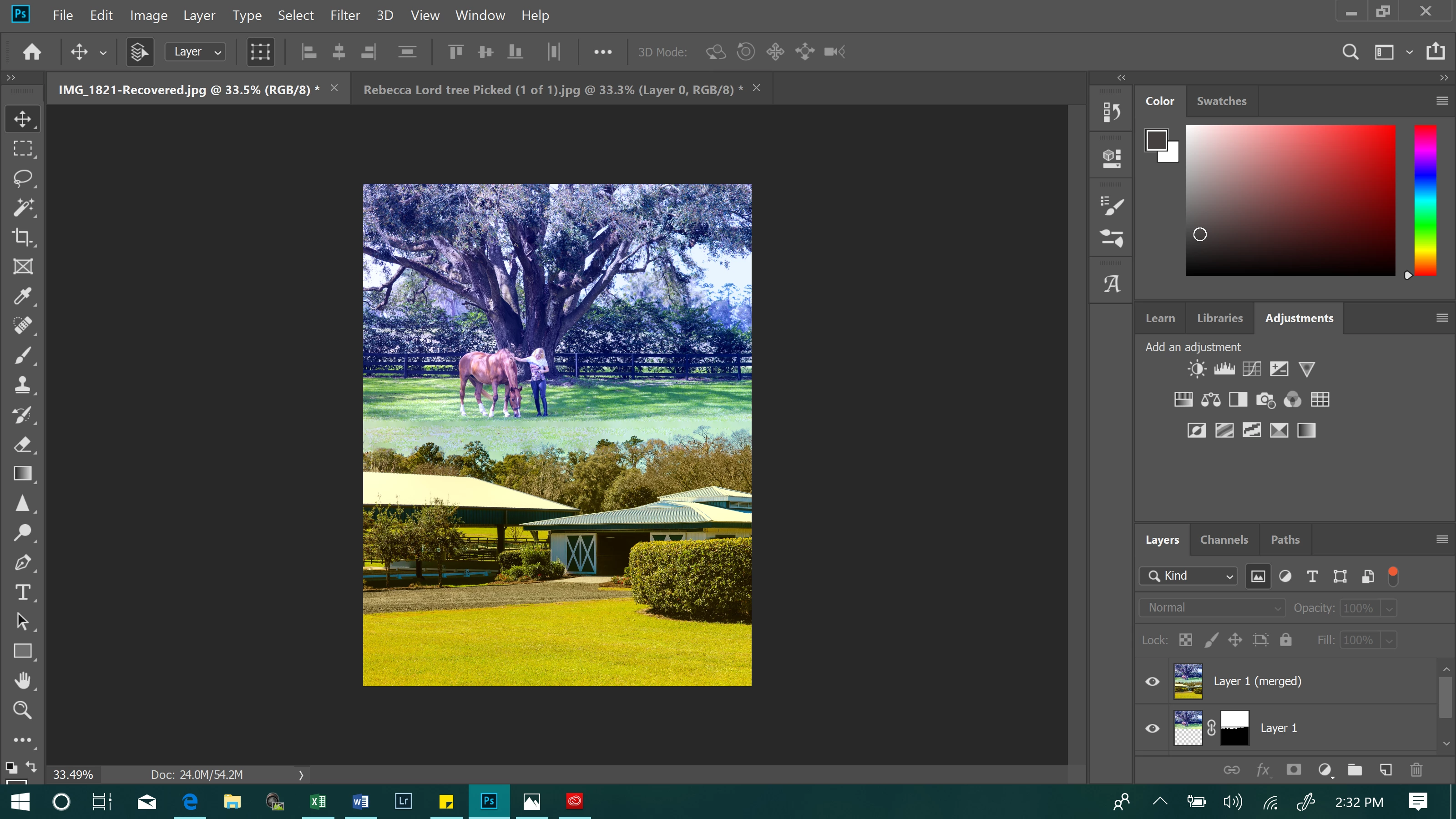

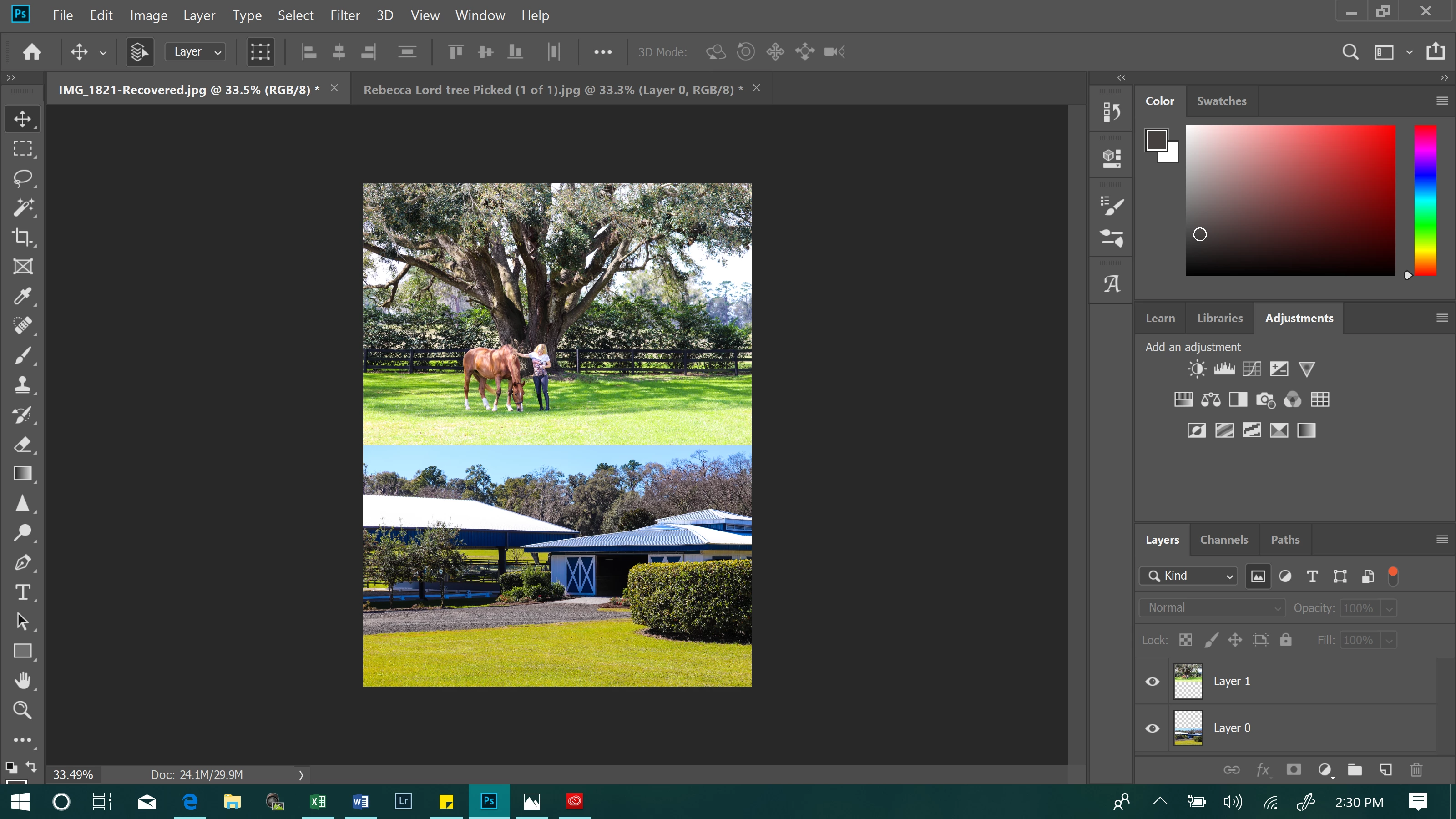

    In the almost final project the 2 photos have fairly drastic color differences in the grass. Now these photos were taken weeks apart at different times in the day and here in Florida where we are getting our spring grass in. What I need help with now is, how do I make slight adjustments to the curve on the bottom photo but not on the top?
    Should I edit the photo separate and then load it into the ad?
    When I select Curve and make adjustments it adjusts the whole image not just the bottom photo.

    There are several techniques, here is one:
    Make a Selection (try Select>Color Range),
    then apply an  "Adjustment Layer".
    Good Luck

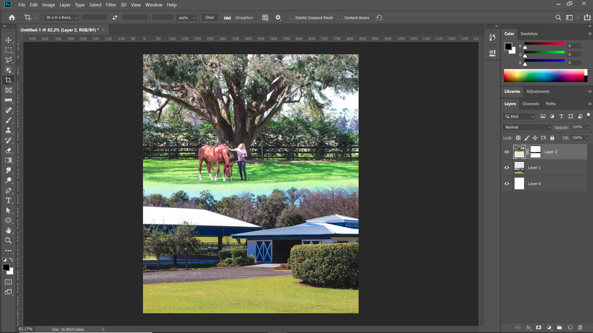

    It would be best to overlap the two images then you can blend them together with a mask and/or adding a third layer to hid/fade the transition.
    Or with a transition:
