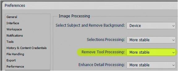

    @Aaah-Doh!-be
    Do you have Generative AI on or off? Is the tool set to Faster or More Stable?
    All generative AI is sent to Adobe’s servers for processing.
    I’ve tested extensively on a big file (eventually covering most of the image) and I don’t see any problems. It’s responding entirely as I would expect. But that’s with AI off and More Stable.
    May 1, 2026
    AI off, more stable are my settings too.
