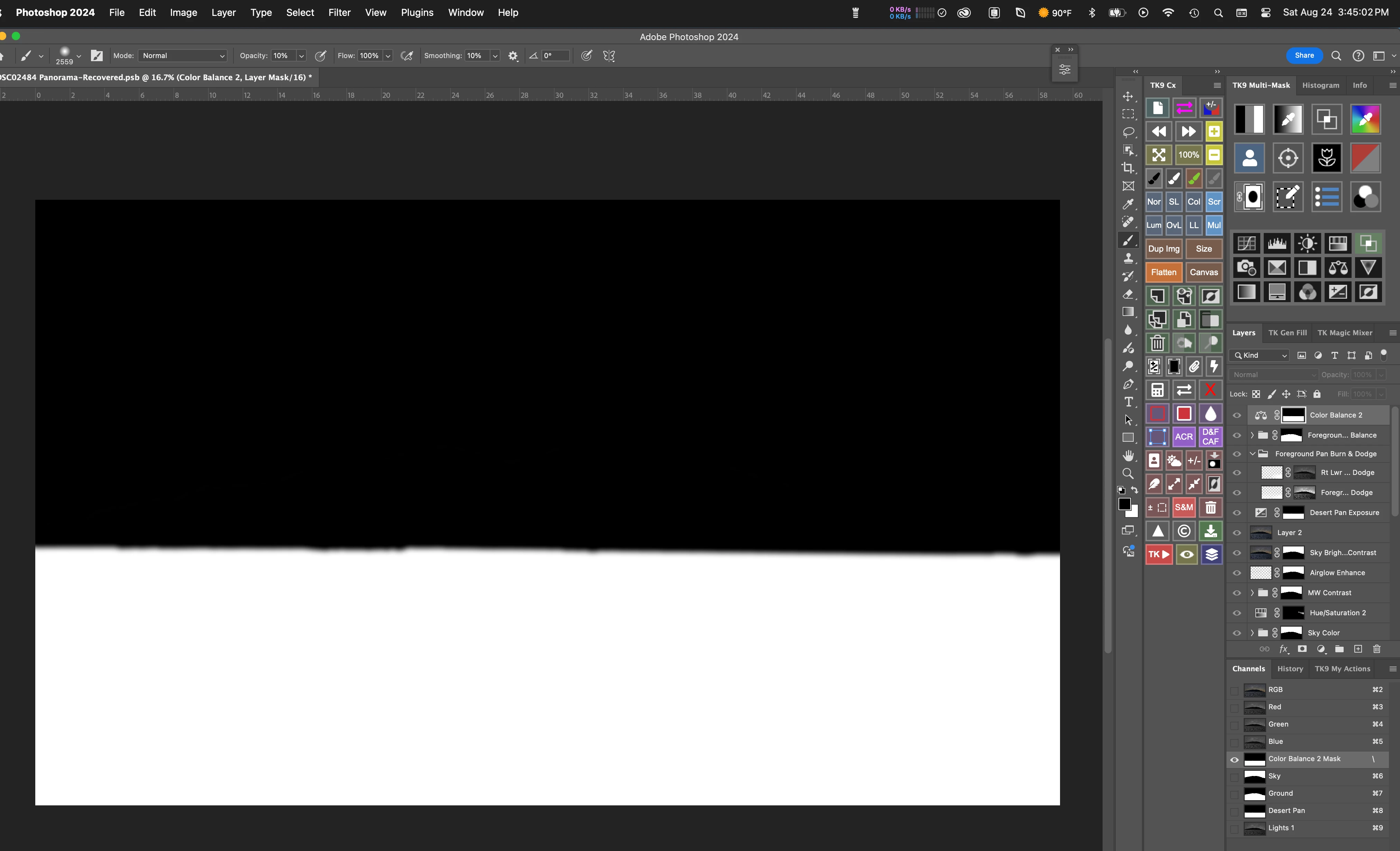

I have an adjustment layer that I have applied a mask to by Command-Clicking the channel that I saved when I created the mask and dragging it to the layer. The mask is half black (top; sky) and half white (bottom; ground) So far, so good.

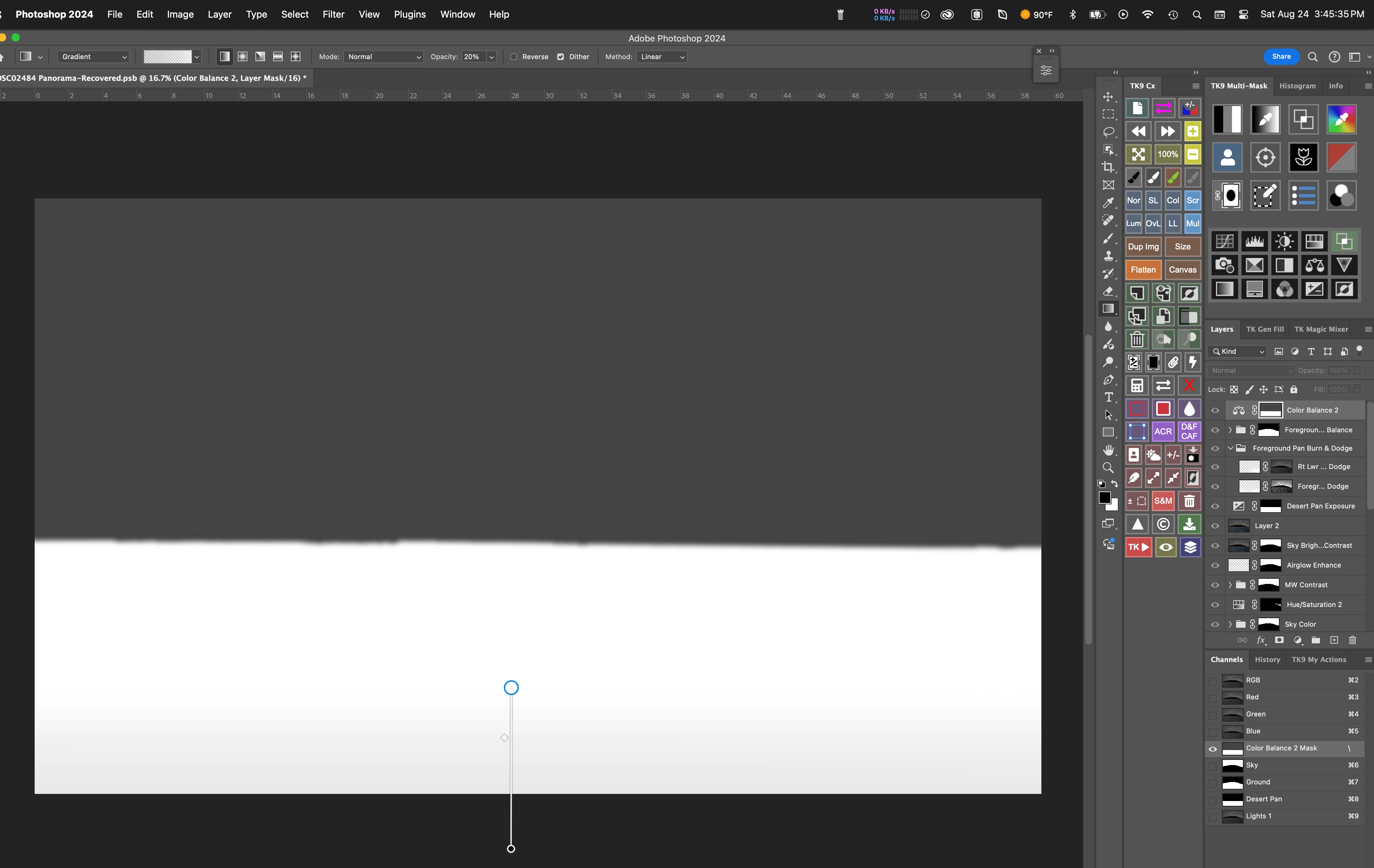

I have selected the Gradient tool and want to drag some low opacity linear gradients into the bottom and lower corners of the white portion of the mask (I want to partially mask these areas).
But when I click-and-drag the gradient tool the top, black portion of the mask turns gray!

Many thanks to Spas K., Bojan, and davecm. I've figured it out and want to share the answer.
I needed to go to the "Select and manage gradient presets" drop-down in the Gradient Tool Bar, then in the "Basics" folder select the "Foreground to Transparent" thumbnail.
The new Gradient Tool has...well...lots of curves...and knuckleballs.
Thanks again for the assistance. You made me think.

Attached are two screenshots of the mask, before and after attempting to use a linear gradient to edit the mask.

Thank you. I have attached two screenshots, before and after attempting to edit the mask, below.
