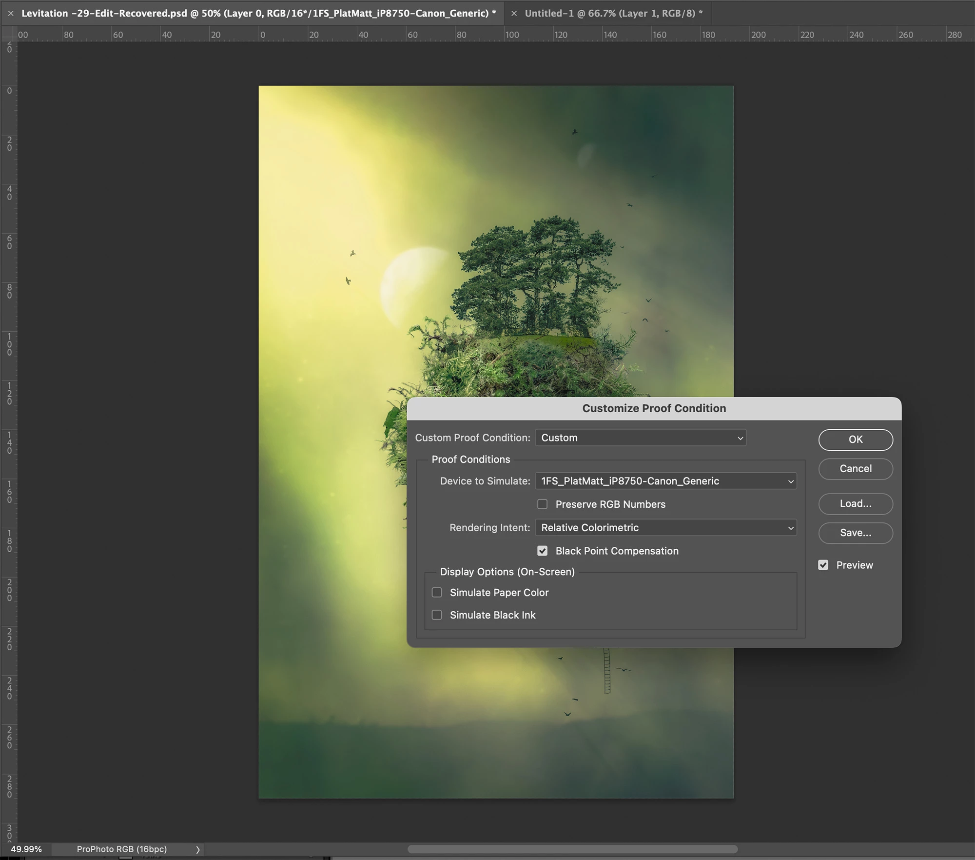

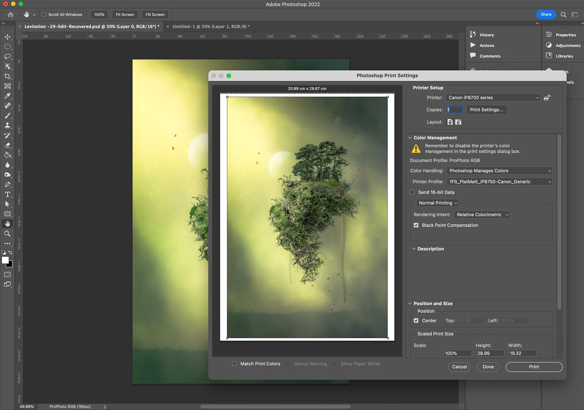

  1. First screenshot: Print dialogue box - colours are good (note that colour management is disabled in the printer settings), but the print is muddy (see last screenshot).
  2. Second screenshot: Custom proof - colours are good on screen, but the print is muddy (see last screenshot).

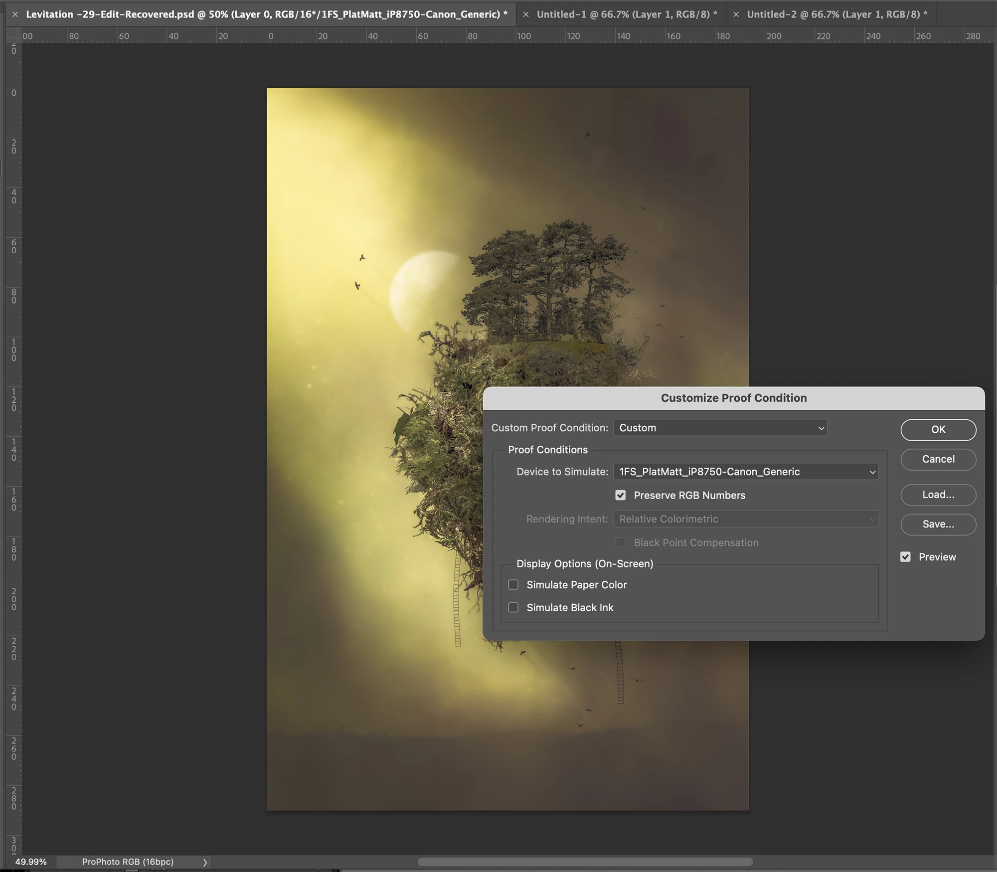

  3. Third screenshot: Preserve RGB numbers enabled - these are exactly the muddy colours that are printed. If I understand this correctly, this represents how colours will look if there is no colour profile on the source document - note: whether the source is ProPhoto or Adobe RGB, the result is the same muddy colour version.
