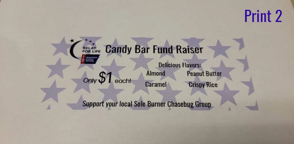

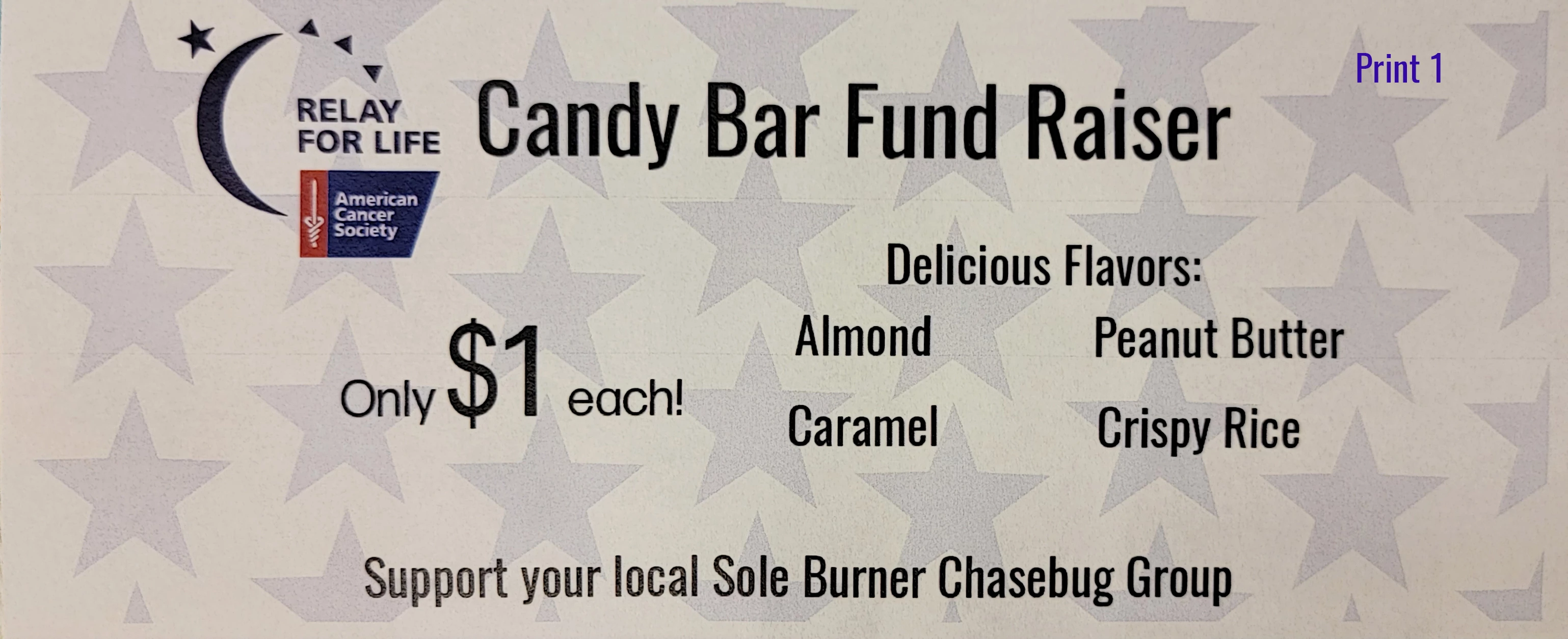

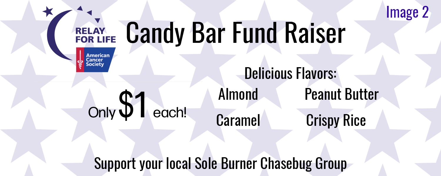

Hey everyone, I'm going to try and explain as best I can to get the help I need. I'm trying to create a sign for work with a star pattern in the background. I created the shapes in a group and dropped the opacity of the group layer (see image candy bar sign 2). When I printed it though, it came out much darker than what I was seeing on the screen. (See candy bar sign print 2). I had to drop the opacity so low you can't even see it on screen (see candy bar sign 1) to get it to print how I want it (candy bar sign print 1).
