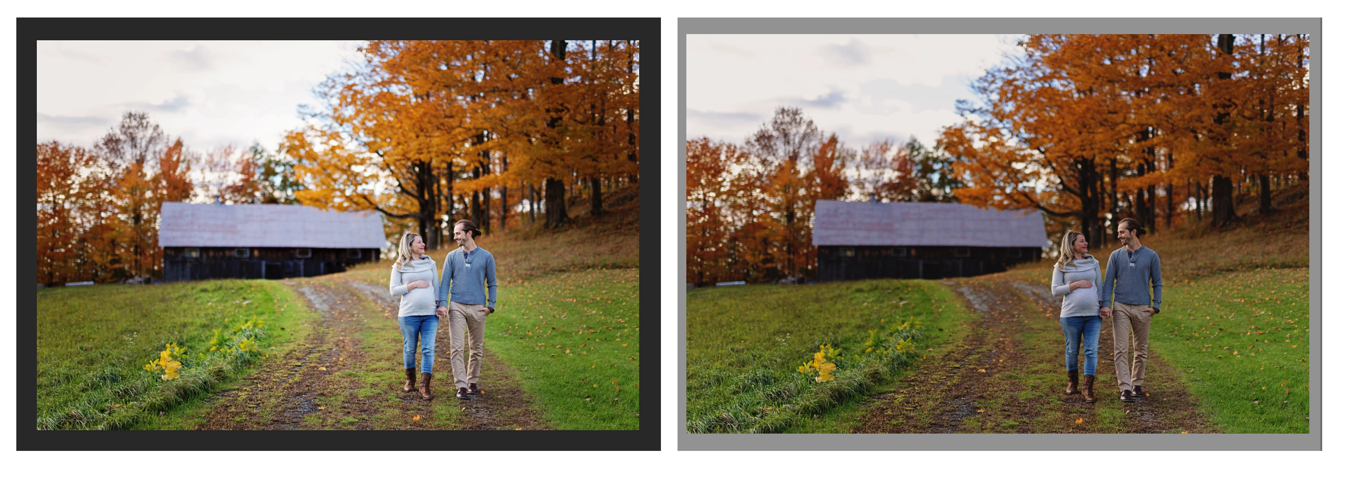

    Here is the pictures !

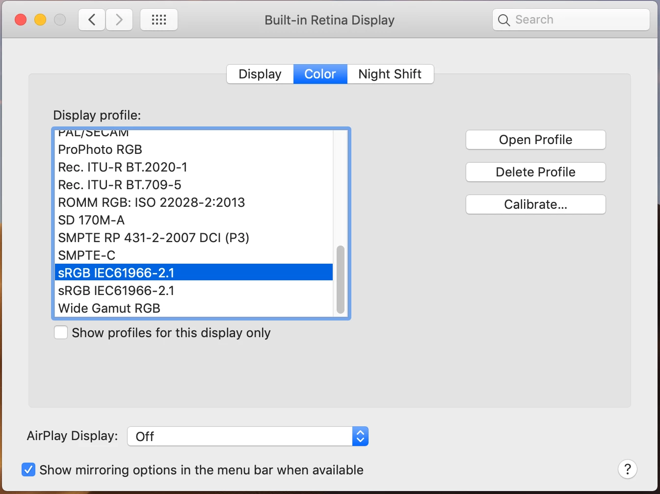

    I did put my display color profile to sRGB.
    For the color management in PS, I put it to North America General Purpose.
    Here is what is happening step by step:

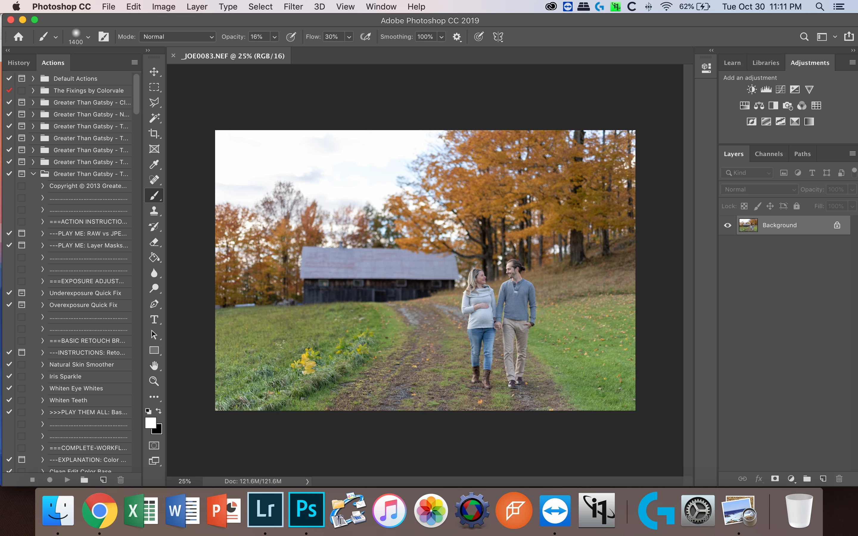

    1- I open lightroom and choose a picture and press CMD+E
    2- Then PS is opening the picture with the same color, brightness, gamma,
    etc

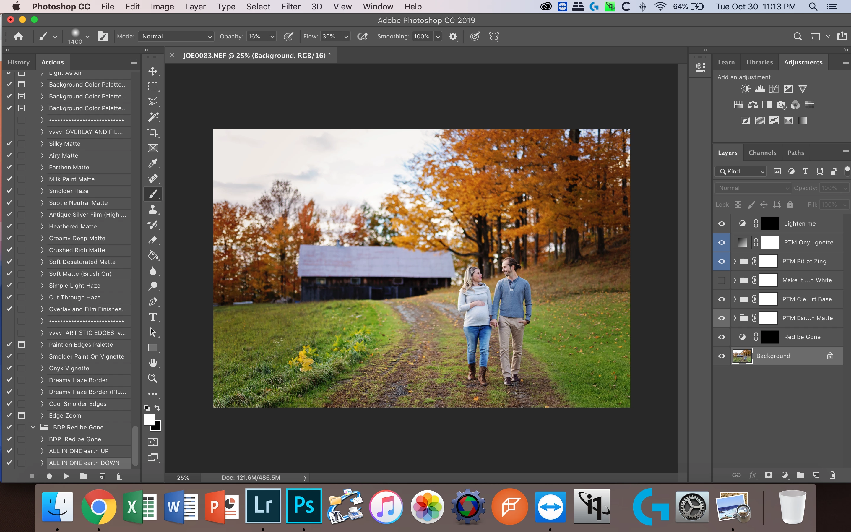

    3- I do the changes I need to do to the picture and press  CMD+S (In other
    to save the PSD in lightroom, next to the original raw file) (the picture
    below show what it looks like in PS)

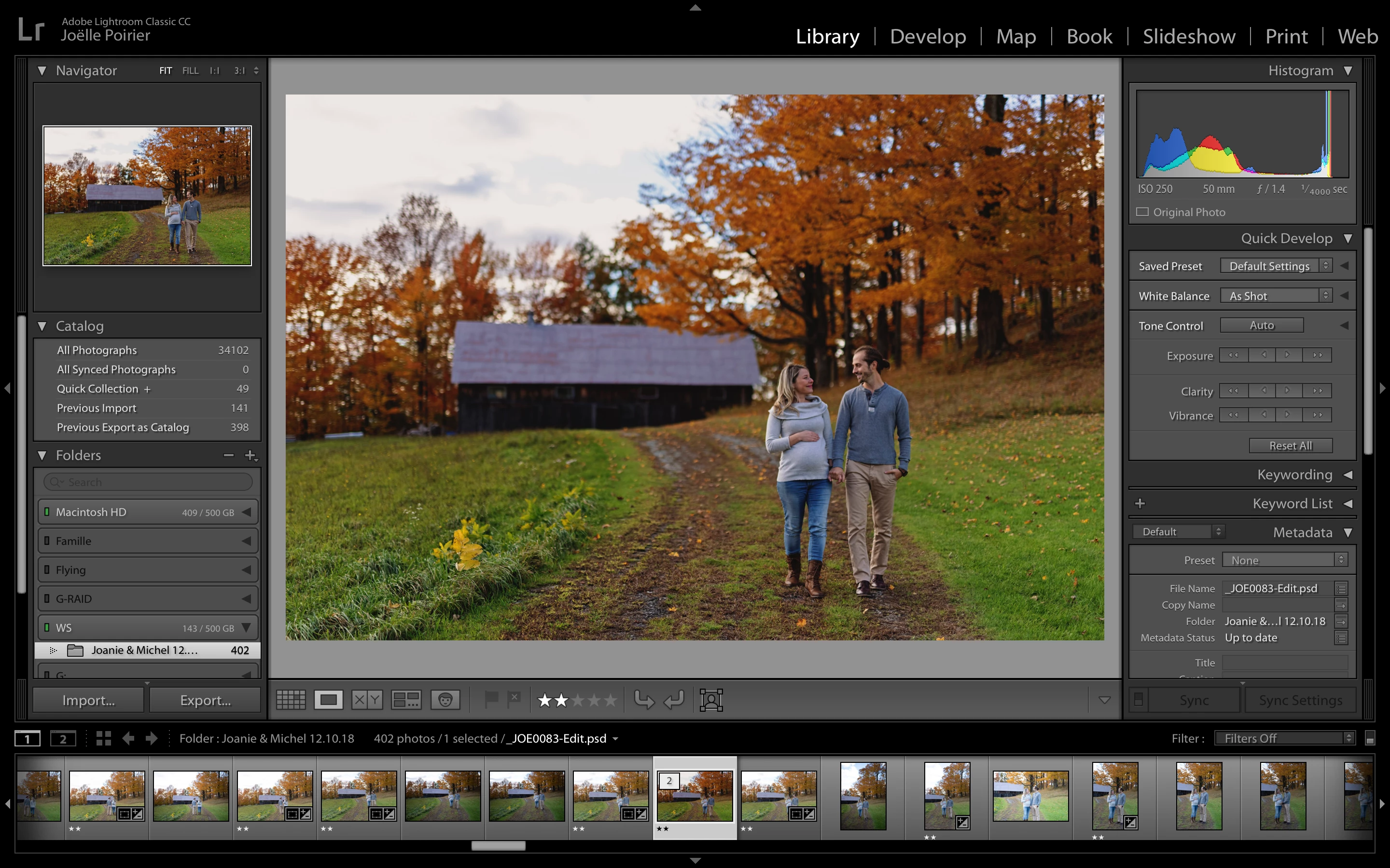

    4- Back in Lr, here's the PSD I just saved:  (it's darker)
    So that's the problem.
    This problem occurs right after I did lunch the installation of the latest
    version of Ps and Lr.  It's the same problem that started at the same time,
    on both computer, my PC and my Mac.
    Here is both pictures side to side (Left=in Ps and right=the PSD saved in Lr)

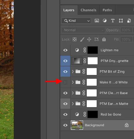

    I see you have visibilty turned off for one layer group in Photoshop, could that be causing the problem?
    Joellle
    JoellleAuthor
    November 3, 2018
    It has no link to the problem sadly.

    It appears you didn't understand that. To rule out a defective monitor profile - not document profile! - you change the default profile in the operating system, from the current profile, to sRGB IEC61966-2.1. On Windows it's here:
    Relaunch Photoshop when done, it needs to load the profile at application startup.
