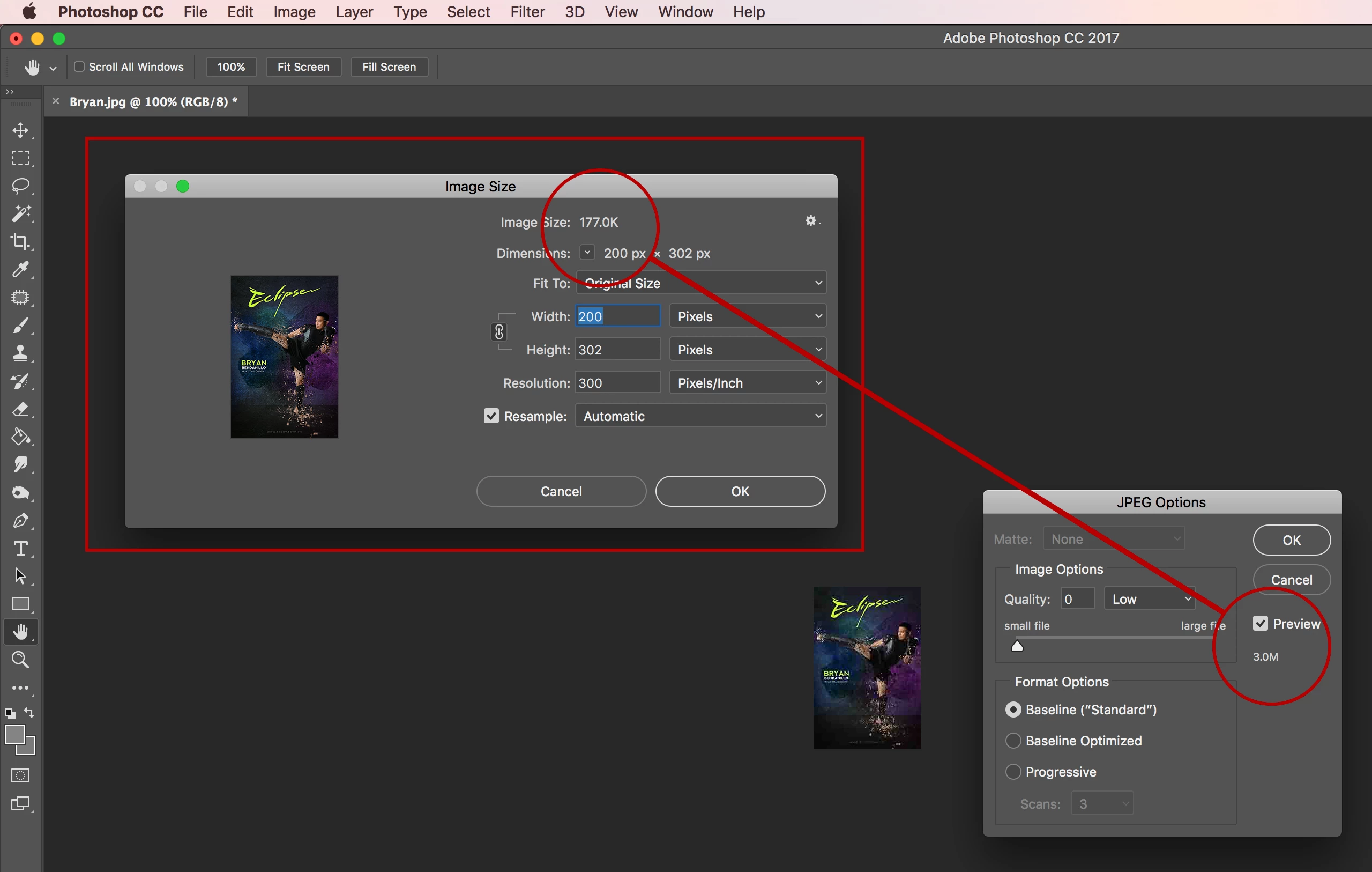

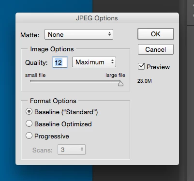

Whenever I'm attempting to save a JPEG in Photoshop CC, even the smallest size JPEG comes out at around 6MB at least. I've tried everything from rebuilding the file to flattening all the layers, yet nothing seems to have worked so far. I'm trying to create web graphics and the file should typically be around ~100KB. Anyone have any suggestions on what I can do to fix this? I've tried restarting the computer and resetting the preferences file for Photoshop but it still won't work.

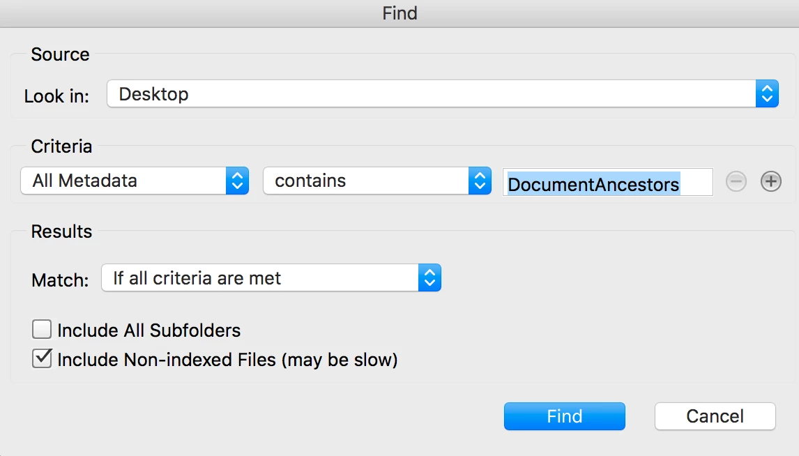

Stephen Marsh
June 14, 2017
Yes, it’s DocumentAncestors metadata again (around 15mb of bloat), this Bridge search isolated your images as matching this criteria (as does using File > File Info):
Again, my previous posts #58 and #59 in this topic offer solutions to this issue.
I recommend setting up the Photoshop script in Script Events Manager on all computers and also installing the Bridge script to put out spot fires where needed. Direct links to the script source code:
Re: Inflated JPG File Size  - Photoshop Document:Ancestors Metadata
Bridge Script to Remove Photoshop DocumentAncestors Metadata
Keep in mind that a simple export/save for web can also strip metadata, which should be used for “web” images, however sometimes users need to send out hi-res data or CMYK etc, so export/save for web is not always suitable and then these Photoshop or Bridge scripts will be necessary if the files are bloated.

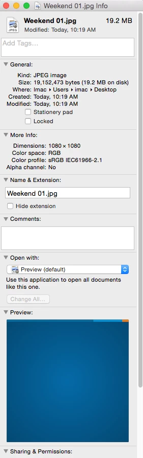

February 9, 2017
This problem just showed up in my photoshop CS6 as well.  Up until a week ago, files were saved at a reasonable size.  For three years, there has been no change in my process, no change in my hardware, no change in my software.  Suddenly, even a white background 4x5 inch photo with nothing other than black text on it comes in at over 6MB.  I don't understand how a bug could "suddenly develop" when there have been no changes in anything on my end.  I ran MacAfee and this does not appear to be the result of a virus.  I'm in CS6,version 13.0.1.
Any suggestions on resolving the actual problem, rather than creating a whole new process of saving as a PNG, opening, then resaving as a JPG (which did actually work) for all of my many, many pictures that I process each week?

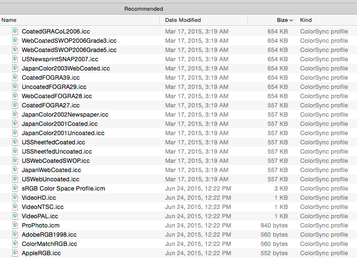

December 30, 2016
A profile need not be just 3 kB. A CMYK profile is typically multiple megabytes.
Earth Oliver
December 30, 2016
multi meg cmyk profiles? what in the world are you talking about?

D Fosse
December 30, 2016
Mike Arrowsmith wrote:
I eventually resolved it by disabling the 'Include ICC profile' option so that seems to be where the problem lies
An icc profile is only 3 kB, so that simply can't be, unless the profile is massively corrupt. It is never a good idea to strip the profile.
It is known that file history metadata sometimes can balloon a file to enormous sizes (several MB). I rather think that's it.
Try Export or Save For Web with metadata set to "none" or "copyright". That should strip out all those megabytes.
December 30, 2016
Well, it it simply *can be*. Whether or not it's a corrupt profile I don't know, nor would I know how to tell, but this definitely resolves it for me. Screenshot attached of image processor results:
.jpg is with included ICC profile
_1.jpg is without ICC profile
_2.jpg is with ICC profile, but with 'convert profile to sRGB' selected.

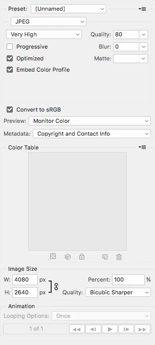

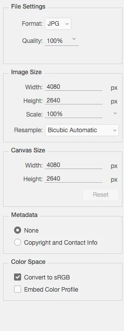

December 16, 2016
I have been using PS since 1997 and After the latest update, I have a set size I use, 4080 x 2640 @ 300 ppi for all my poster prints... Every time I use Export AS and JPEG my printer is getting a huge file.
The resulting file size is huge and the printer called me and said that the image is over 56" x 36"!
So I tried the cropping tool again..... this time set it to inches..... 11.25 in x 17.25 in  @ 280 ppi
SAME RESULT IN EXPORT!
So I am pretty sure this is a major bug in Photoshop!
So I went in and Used the legacy "Save for web" as so...
STILL SAME RESULTS.......
If a crop is made at 11in x 17in @ 300.....  The size should not be more then 11x17 on export... Never happened in the past....
Now I have to export the file and go to preview in MAC and resize the image to 11x17 @ 300 for the image to be in the correct sizing....
IT IS A PHOTOSHOP ISSUE!!!!!!
gener7
December 16, 2016
There is a setting above Copyright and Contact Info in Save for Web that includes Print Metadata. I think it's "All".
Try that and let me know. That setting should keep your 300 ppi setting.
