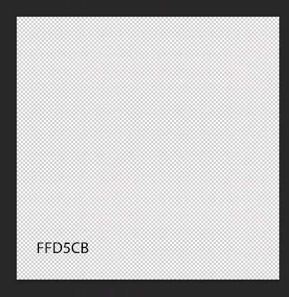

March 14, 2021
There is only one text layer per file, and I have placed the text layer in the same spot for every layer.
New solid fill would be a new layer on top (making hex value irrelevant visually).
Please let me know if I can expand more:
-current tiff file with one text layer (pulled using variables following PiXimperfect's tutorial):
- Theorteical end result:
March 14, 2021
Whoops, .psd files. I doubt that matters though
