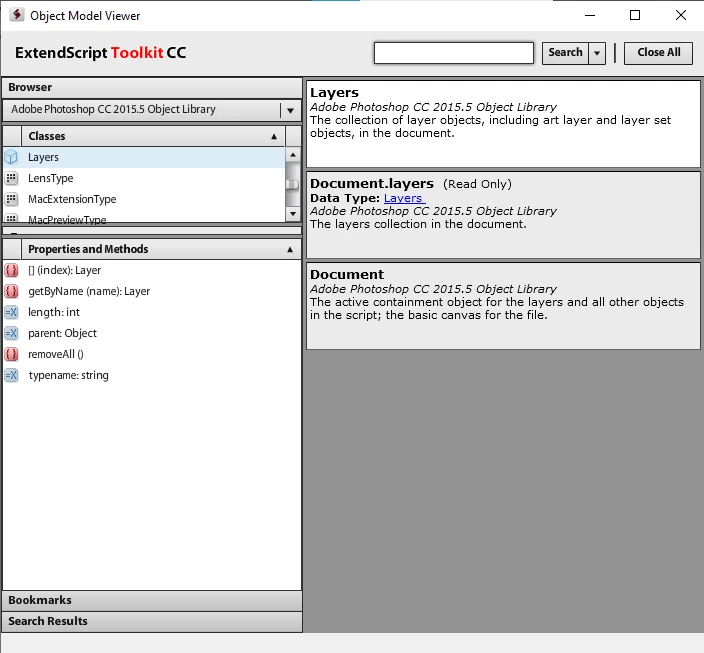

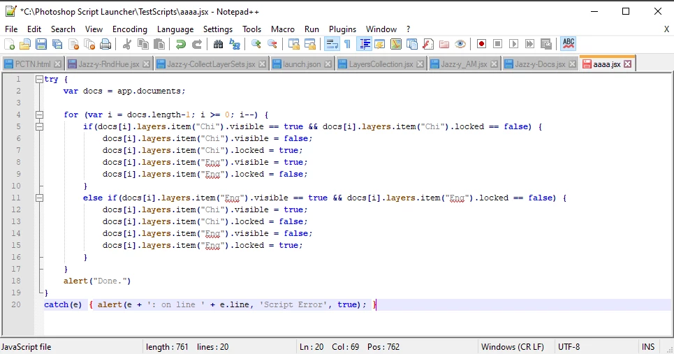

I added a little code that will help you find errors  in your code
When you run your script the code will help point to errors..
When  I ran your code it showed

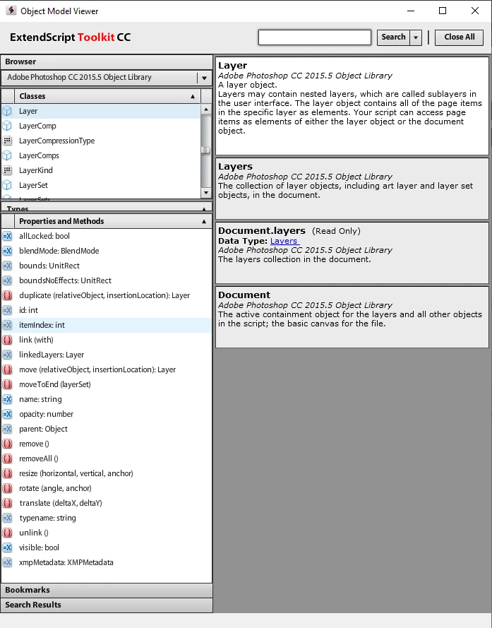

Looking at Layers object I do not see a property element "item"
looking a a Layer object  I see a property itemindex  and a name the could be "Chi"
You need to use Adobe Photoshop Object model
