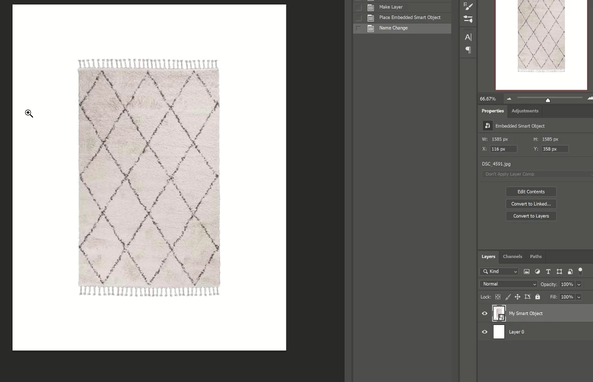

Hello everyone,
I have a document with a smart object on it:
I have this image path: "E:\REPLACE SO\DSC_4591_Round.jpg"
I want a script to replace the smart object with the image path i have without using a dialog to select the file, is that possible?
This is what I've tried and it doesn't work:
var mySmartObjectLayer = activeDocument.artLayers.getByName("My Smart Object");
var PathFile = "E:\REPLACE SO\DSC_4591_Round.jpg";
var myFile = File(PathFile);
replaceContents(myFile, mySmartObjectLayer);
function replaceContents(newFile, theSO) {
    app.activeDocument.activeLayer = theSO;
    var idplacedLayerReplaceContents = stringIDToTypeID("placedLayerReplaceContents");
    var desc3 = new ActionDescriptor();
    var idnull = charIDToTypeID("null");
    desc3.putPath(idnull, new File(newFile));
    var idPgNm = charIDToTypeID("PgNm");
    desc3.putInteger(idPgNm, 1);
    executeAction(idplacedLayerReplaceContents, desc3, DialogModes.NO);
    return app.activeDocument.activeLayer
Correct answer r-bin
Try
"E:\\REPLACE SO\\DSC_4591_Round.jpg"
r-binCorrect answer
May 1, 2021
Try
AG_Ps_100
AG_Ps_100Author
May 1, 2021
Works. r-bin you're the best as usual.
