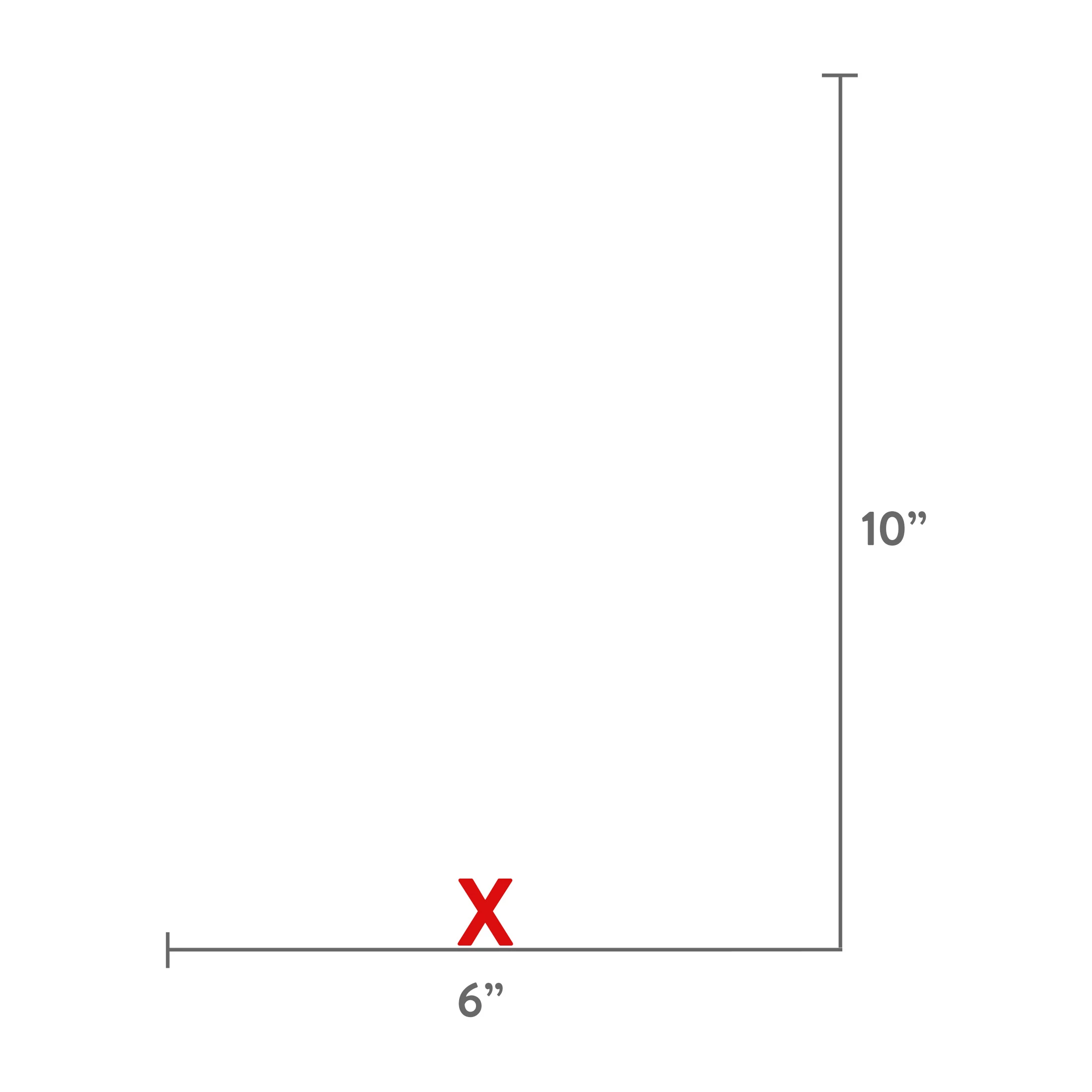

Hi All,
I have very little knowlidge on javascript. I want a script to be use for mutiple images of difference sizes which needs to be pastes to a new layer in specific x, y location.
Thanks
Ed

Hi JJMack,
When I referring multiple image, I meant batch process where I need to create scale value for multiple image. I am pretty sure that the image would not be bigger than the canvas as the source image would be of lesser resolution. I want to give a value X and Y location and have the image get pasted to that specific location.
Something like this
X  = 850
Y = 1600

As I'm only a casual/hobby scripter, I would "cheat" (as I don't know an elegant way).
So, first I would select all, then align the active layer to the selection, then deselct. Perhaps you can create the selection in a targeted position so that the object is aligned exactly where you need it from the start:
