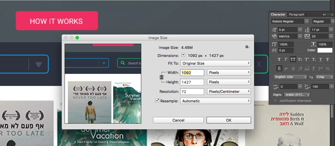

You have pixels per inch in one, and pixels per cm in the other...
(72 pixels per cm is 183 pixels per inch)

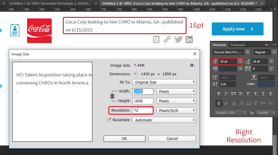

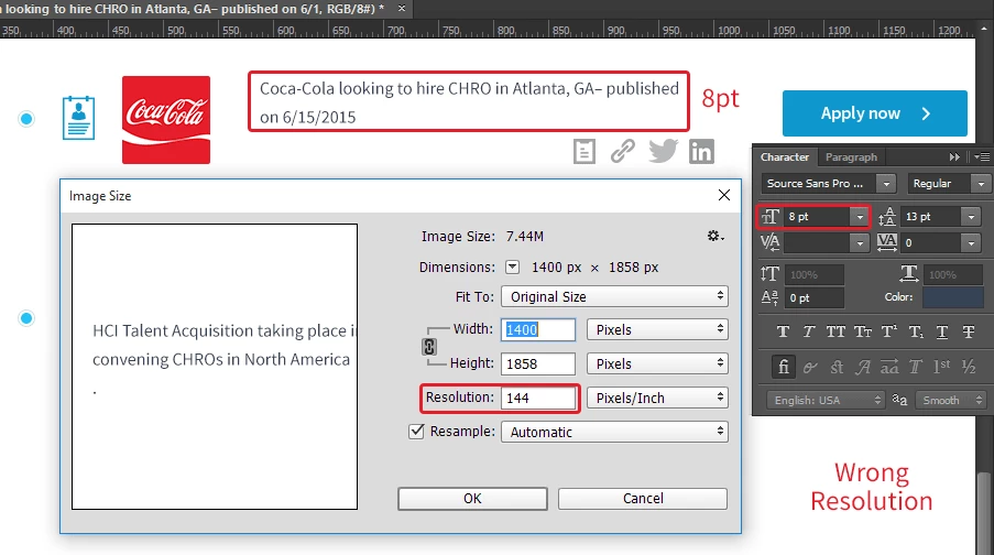

September 26, 2015
Hi Designers,
Here how to solve the problem!!
Problem is about Resolution, if you get smaller of bigger size in type tool, be sure that you have the wrong resolution (NOT 72 dpi)
You can see the difference in images bellow.
HOW TO SOLVE : drag layers in new file with the same size and make sure the resolution is 72 dpi! and it's DONE!
(changing the resolution in the same file will just make ALL layers smaller or bigger and don't solve the problem.)
Wrong Resolution:
Right Resolution:
I hope that helps

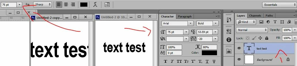

January 7, 2015

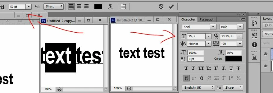

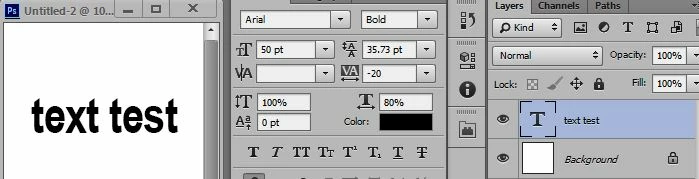

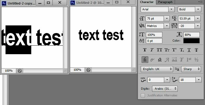

it seems is that in CS6 when you change your font size using free transform - it "remembers" the original pt size when you select the text itself in a certain way:
The Problem
I am writing the text in 50 pt size
I duplicated the document and scaled the text using free transform in 150%
now when I click inside the text more than once and select some of the letters or even just move the indicator more than once
it shows me it is still 50pt which is of course not true.
so as it appears photoshop can occasionally give you the text size before you made a transformation
The Solution
a way to get around that is to click only once and drag through at the same time with the first initial click
now you can see the true font size is 75 pt and not 50 pt.
to contribute to the confusion it appears the font size in the toolbar stays the same "wrong" size so beware of that
and if you want to be really sure you can select just the layer in the layer panel (not the text)
and you will get your "true" font size.
I made the same test in photoshop CC  14.2.1 and it does not act this way but instead it gives you the "true" font size even if you scale it in free transform
and select clicking more than once.
hope this will clarify the matter.
