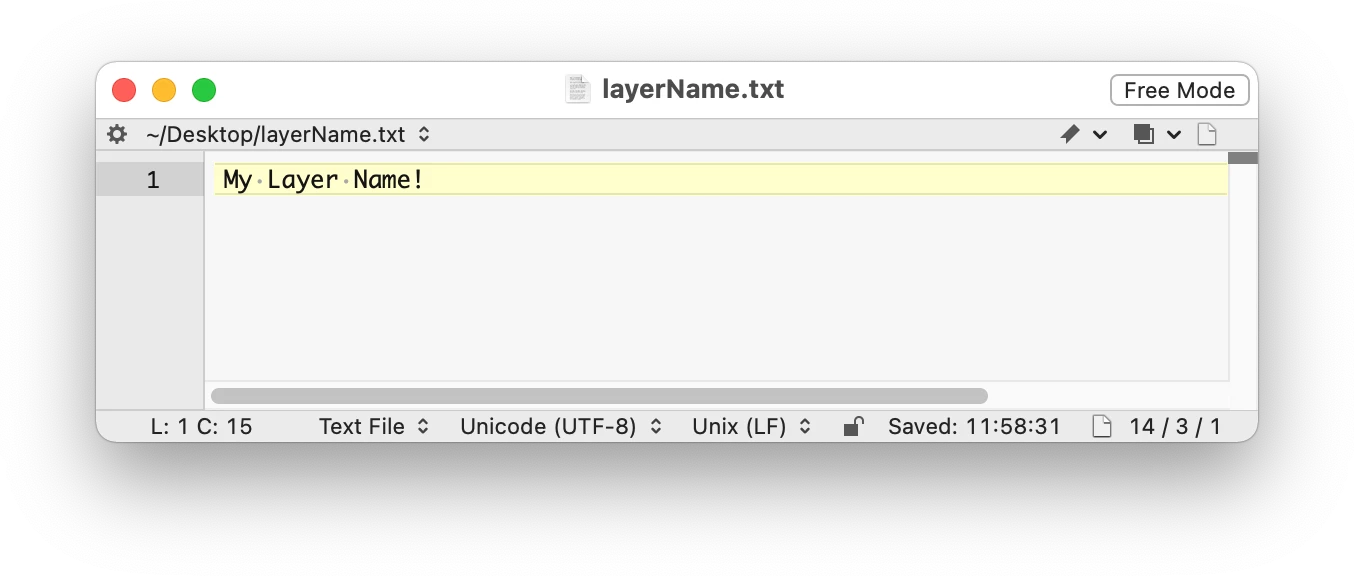

A simple text file on the desktop, named "layerName.txt":
Sample code:

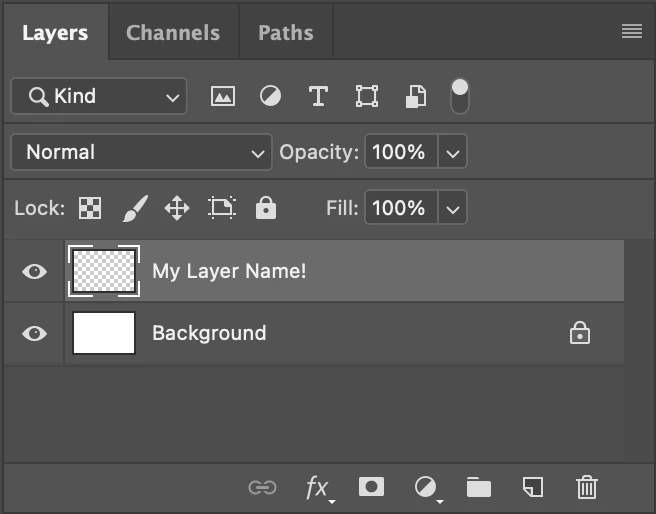

The result:
This is a simplified example, you will need to process multiple lines (breaking them on return/newline or comma-separated values) and create layers or layer sets from each line as desired. You could "flag" the line in the text file as either being a layer or layer set and process accordingly. You may also need to nest and or move layers in the stack or possibly do other things that have not been mentioned.

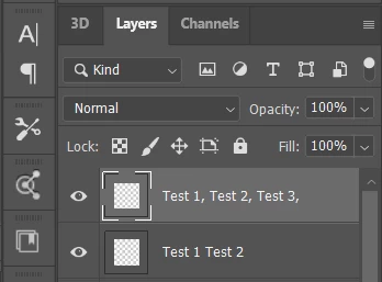

Yes, exactly I need a very simple tool. That I can create a lot of layers without rewriting.
This worked but puts all existing text in the "layerName.txt" file as the layer name.
while I want to separate, for example, with a comma or line by line.

Indeed, this is why I wrote:
"you will need to process multiple lines (breaking them on return/newline or comma-separated values) and create layers or layer sets from each line as desired."
