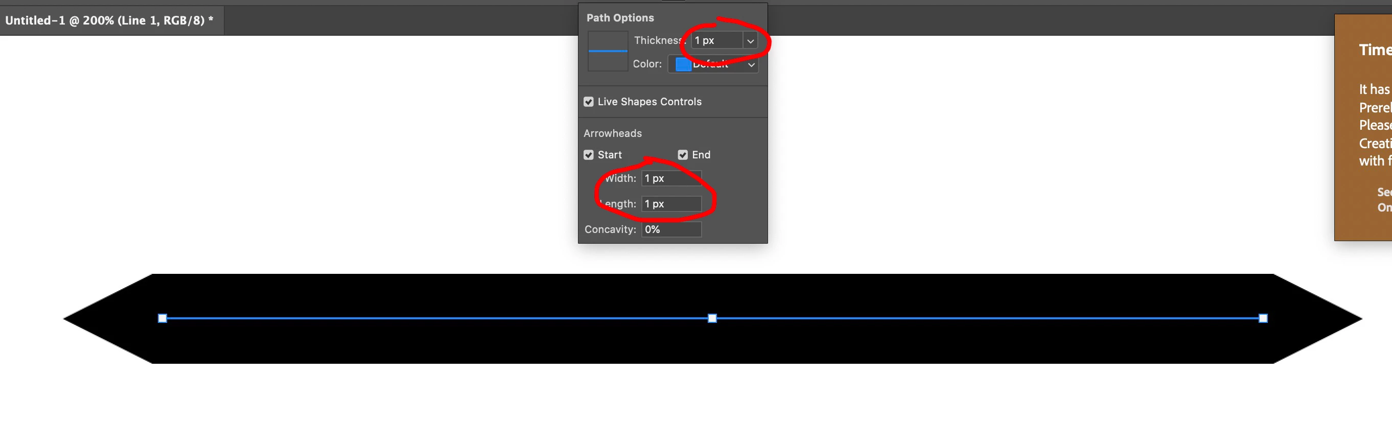

Using only the Line Tool/Straight Line Tool in Photoshop 24.2 on Mac OS, can I taper the ends of the lines instead of them being blunt and square? Arrowheads setting will not do this.
Correct answer Mike_Gondek10189183
Actually, you can do it with arrowheads with the right settings

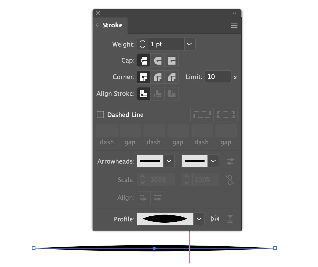

In Illustrator use stroke profile

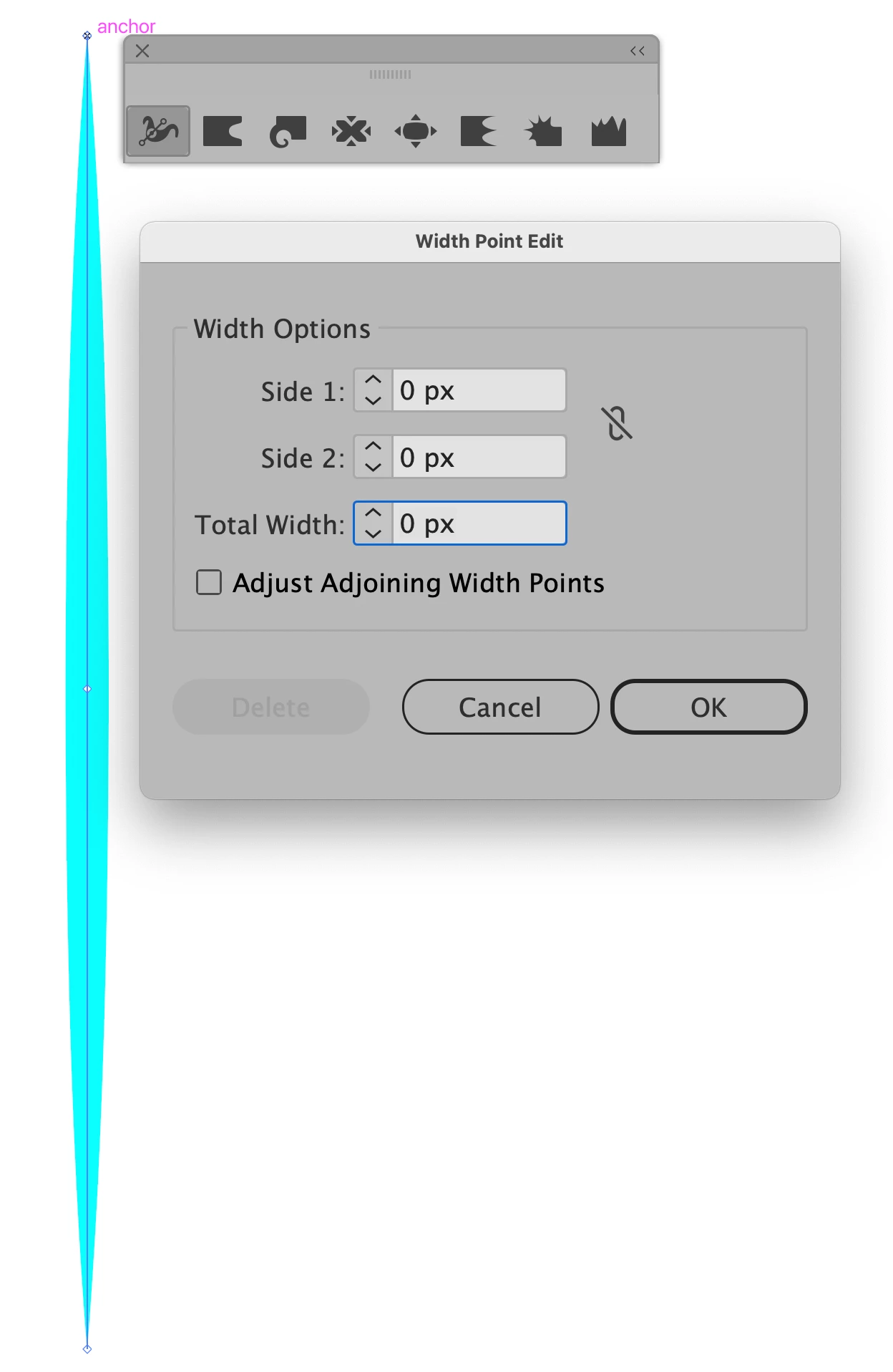

I can't think of any way to do this in Photoshop, but Illustrator does it quite easily.
In Illustrator. you use the Width tool  (Shift+W) and add a width point as wide or as narrow as you desire to the middle of the path. Then you double-click the top anchor point and set the total width to zero. Repeat for the bottom anchor point.

Mike_Gondek10189183
Mike_Gondek10189183Community ExpertCorrect answer
March 18, 2023

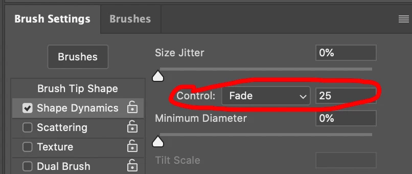

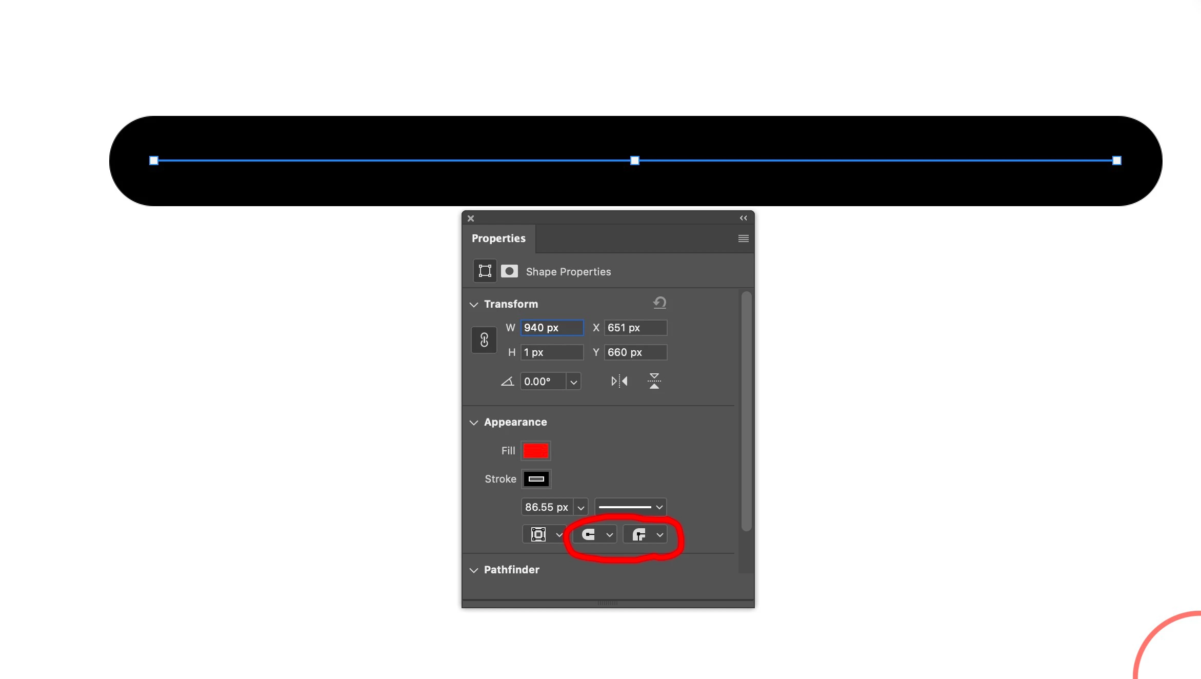

Mike_Gondek10189183
March 18, 2023
Best you can do is roudn the edges, ntoy a pointy taper.
You could use the line tool to draw a vector path, and then change your brush setting to taper by setting fade in the brush settings.
I don't like that as is hard to guess how many pixels to set and takes alot of back and forth. I would recommend you do in Illustrator, copy and paste it into photoshop.
