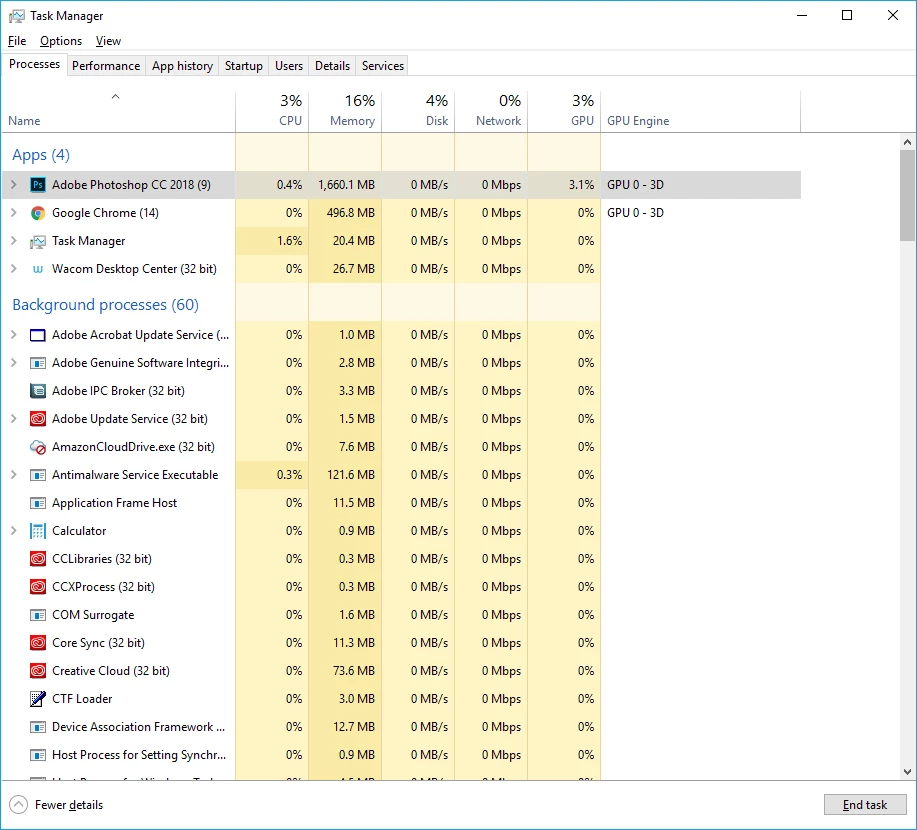

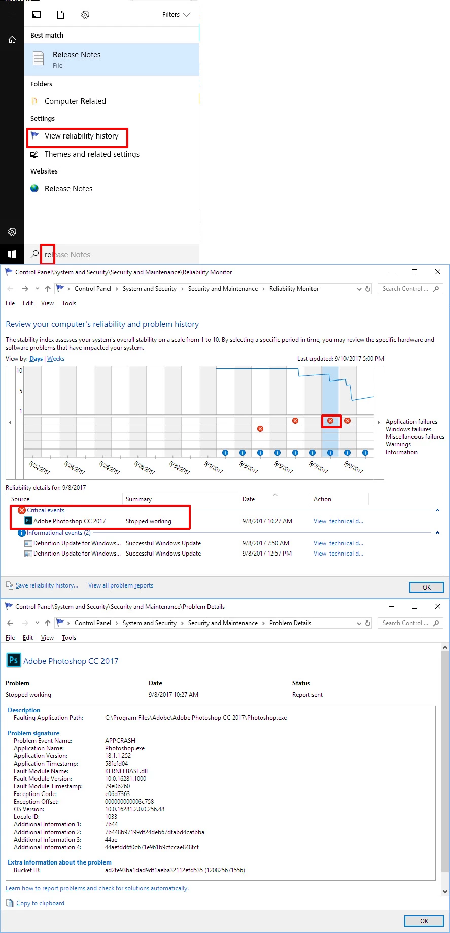

JJMack
January 15, 2018
If you using windows start the task manager.  So you can see the running porocesses try to start Photoshop do you see it try to start in the task manager.
Also use the Windows reliability history viewer see it there are Photoshop crase reports.
