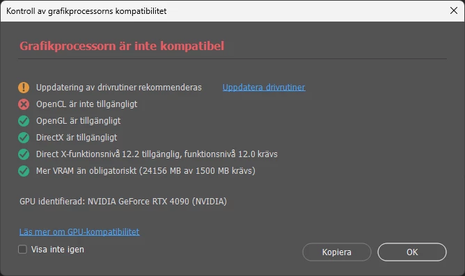

Photoshop won't work with Graphcs Processor, RTX 4090
  • November 2, 2023
  • 9 replies
  • 2309 views
1. Photoshop version 25.1
2. Windows 11, Ryzen 3950x, RTX 4090, 2nd gpu GTX 1050ti, 128gb ram
3. Basic steps to reproduce the problem: Try to do anything, even trying to close Photoshop
I get an error every time I try to do anything while the "use graphics processor" is enabled.
What I have tried:
-update photoshop
-reinstall photoshop
-use photoshop beta
-install new nvidia drivers
-install new drivers with DDU
-disable openCL
-enable older gpu mode
The only way I can get it to work is when I reset it to default, and it works the first start, but it's still limited, like I cannot drag and drop anything into the software. After a restart of the pc or photoshop it's back to square one, and I have to reset again. I use functions that only work with graphics processor enabled, so no, I won't use it with it dissabled.
Suggestions welcome, thank you.

@tennet78 As suspected you have a 4090 but also a Intel(R) UHD Graphics 770 that can be causing a conflict.
Here is how to resolve (basicially disable the Intel GPU):
https://community.adobe.com/t5/photoshop-ecosystem-discussions/set-up-gpu-for-high-performance-in-photoshop-quick-tip/td-p/13504734

@Kevin Stohlmeyer — Thank you! Disabling the Intel integrated GPU solved this. No the error message seems to be gone.
November 21, 2023
Hi @Kevin Stohlmeyer . Thanks for your quick response, please see systeminfo below.

Stereo: FALSE
Bounds: (2,560, 148) -> (4,480, 1,348)
Dimensions: (1,920 1,200)
Physical size: (0 0)
Pixel size: (0 0)
Dynamic range: (0 1)
Potential dynamic range: (0 1)
Reference dynamic range: (0 0)
Attached Device: (DeviceID name=NVIDIA GeForce RTX 4090/PCIe/SSE2 index=0)
# devices: 1
Device 0
Name: NVIDIA GeForce RTX 4090/PCIe/SSE2
Preferred: TRUE
Power Envelope: INTEGRATED
Attachment: UNKNOWN
# attached displays: 2
\\.\DISPLAY2
\\.\DISPLAY1
GPU accessible RAM: 25,329 MB
VRAM: 25,329 MB
Dedicated System RAM: 0 MB
Shared System RAM: 68,566 MB
API version: 2.1 (2.1.2 NVIDIA 546.01)
Device version: 2.1 (2.1.2 NVIDIA 546.01)
Vendor name: NVIDIA
Driver date: 2023-10-26 000000.000000-000
Driver age: 1 month
Driver version: 31.0.15.4601
GLSL version: 1.20 (1.20 NVIDIA via Cg compiler)
End platform OpenGL
{1453 ms}
Exit code kExitNormal
End sniffer 2023-11-21 17:59:35
[kStatusNormal, kExitNormal]
[1519 ms]
Finish openGL
[1519 ms]
Start openCL
[1519 ms]
"C:\Program Files\Adobe\Adobe Photoshop 2024\sniffer.exe" -baseTimeMS=99173578 -comment=Photoshop Version: Adobe Photoshop 25.1.0 20231016.r.120 ca99df2 x64 -openCL
[1874 ms]
Start sniffer 2023-11-21 17:59:35
# Photoshop Version: Adobe Photoshop 25.1.0 20231016.r.120 ca99df2 x64
C:\Program Files\Adobe\Adobe Photoshop 2024\sniffer.exe -baseTimeMS=99173578 -comment=Photoshop Version: Adobe Photoshop 25.1.0 20231016.r.120 ca99df2 x64 -openCL
{1541 ms}
Start platform OpenCL
[kStatusCrash, kExitUndefined]
[1874 ms]
Finish openCL
[1876 ms]
Finish GetSnifferResult
------- Sniffer output

Kevin Stohlmeyer
November 21, 2023
@tennet78 go to Photoshop Help Menu/System Info and paste the entire details here.
My suspicion is you have two competing GPUs - one integrated (most likely an Intel) and your NVIDIA gpu.
The system info can confirm.

Hi @Mark27946700yk5i for your Ryzen go into BIOS and turn off Simultaneous Multithreading (SMT) and restart the computer.
November 21, 2023
I don't have the same error, but I would try to revert to an older driver if I were you. 3-4 months old. For my error I have still not found a permanent solution.
November 21, 2023
Just received my new Windows 11 workstation and I get this popup every time I launch the latest version of Photoshop (25.1.0). I have the latest Studio Drivers installed from NVidia, so there's really no new drivers that can be updated (marked in yellow). This is so bad.. the "number one" image editing software can't handle the best graphics card.
Any tips on how to solve this would be appreciated.
