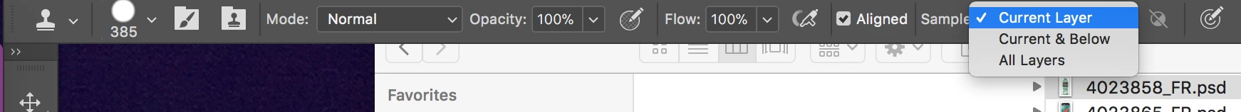

There are several reasons why you would get this error. The first, would be trying to clone on a "background" layer or a layer that is locked. If you see a lock there, you can't clone. Also, pay attention to the "Sample:" drop down menu at the top, where the clone stamp options reside.
If it is set to "Current Layer" and you have created a blank layer above the image (as you never want to work destructively and clone on an image directly), and there is nothing on said layer, you will also get an error.

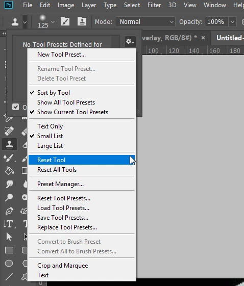

Are the images single raster layers, or is there any vector content like type and shape layers?
Are the layers locked?
Are all blend modes set to Normal?
Try resetting the Clone tool as a first step
