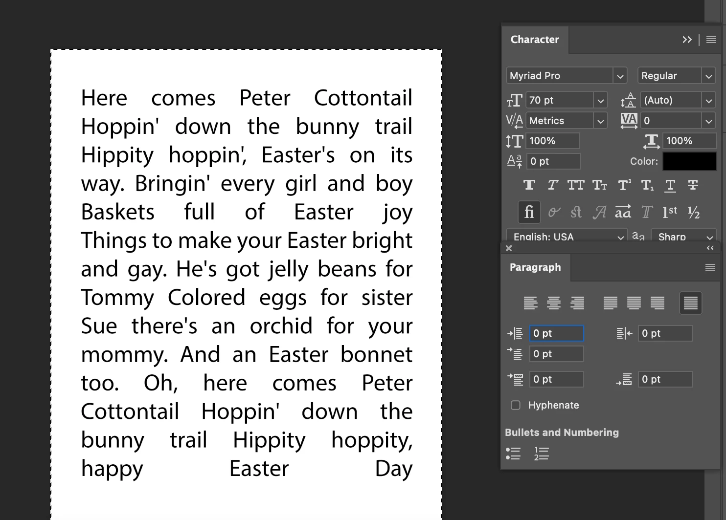

Thanks for the reply!  Here is an example of what is happening (very rough- this would not be final aesthetic). As you can see on the last line the words are incredibly spaced, I am assuming so it can justify on each side.  To make it even would I need to adjust the letter spacing gradually until I get the look I want?

What you are seeing is expected when you have large type, narrow columns, and no hyphenation. All of your lines are loose lines (too much space between the words.) The last line has three words and you want them to stretch from the left to the right, so Photoshop added the needed space between the words to accomplish what you asked for.

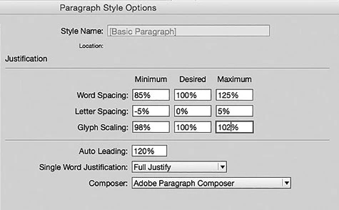

InDesign allows you to control the word and letter spacing to take care of this. InDesign will also flag loose lines. I don't think Photoshop (an image editor) has the same controls, but I'll check when I am back in my office.
To fix this, you need to adjust the type size, column width, and hyphenation. You might also use tracking (Character panel) to manually adjust the spacing. Another option is to add or subtract words.
If the last line is the only issue for you, then you can apply tracking on one or more lines to tighten them up until the last three words fit on the line above.
