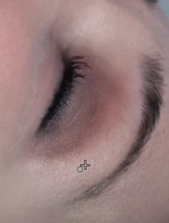

PS CC 21.1.1, macOS Catalina 10.15.4. Using the Clone Stamp tool, I see a plus sign following the cursor that makes it difficult to see the area I'm working om. I expect the plus sign to show up while sampling, but not afterwards. See screenshot below:
Clone Stamp Settings are:
Custom brush, size 20 px, hardness 0%. Mode: Normal, Opacity: 100%, Flow: 80%, Aligned: Checked, Sample: Current Layer

The crosshair shows where the sample point is. As you move your brush to clone, it follows your brush. If it's too close, sample (alt-click) then move your brush far enough from where you sampled, so the sample point won't get in the way when you begin cloning.

Caps Lock toggles the crosshairs on/off for the painting tools. Did you check?
If this still persists, you may need to reset Preferences

The cap lock did not make a difference.
I'll try resetting the prefs - thanks for the suggestion.

Try the keyboard shortcut Command-H. That should hide the crosshair. You can use that keyboard shortcut to toggle it on and off.

What is the crosshair supposed to do when I'm working (not sampling)? I'm guessing if it's there, someone had a use for it in their mind.
