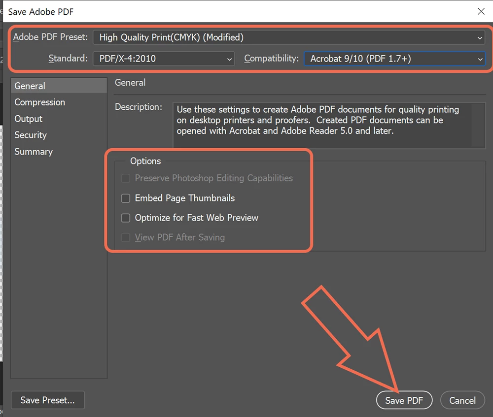

Nancy OShea
February 18, 2020
  1. Open image in Photoshop.
  2. Go to Edit > Image Mode and select CMYK.
  3. File > SaveAs PDF with a high quality print preset.  Ask your print professional which preset they want you to use.

I opened a PNG icon and SavedAs PDF with the following settings.
Give it a try.
