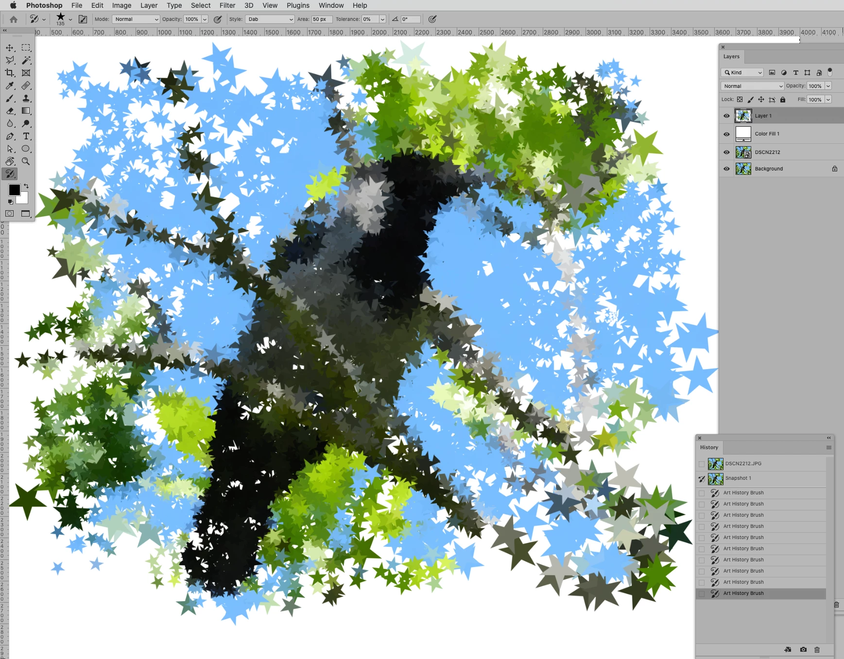

Depending on the time one is willing to put into it the Art History Brush Tool might also be an option.

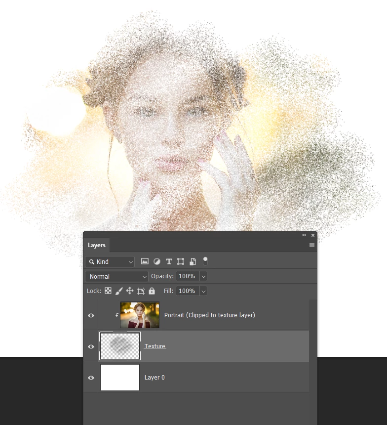

Something you could try.
Make a new layer below your primary image layer, and clip the image layer to it (right click the image layer and chose Create clipping mask. The image will disapear
Paint a texture into the empy layer using black, and the image will start to appear wherever there is a solid tone in the Texture layer

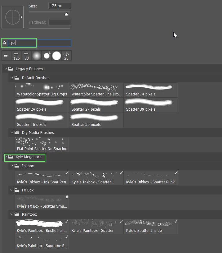

What I did is use the Brush search tool and looked for Spatter presets.
The search tool only looks at groups that are in the main window, but the free Kyle Mega Pack is a safe bet with its 700 plus presets
This will give you the shapes you need, and you can add more effects to it. Bevel & emboss would work well giving you an impasto 3D look.

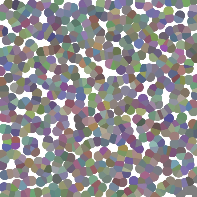

You did a lot of work with the Scripted Fills, didn't you? I did some quick playing around with the random fill and various blending modes, but there's so many combinations, and I didn't find one that worked just right.
I had never looked at the Pointilize filter in detail before. The results sort of remind me of a Ishahara color blindness test without variation in the size of the dots.With a larger cell size, you can get a good idea of what it does:
This is from a solid gray:
