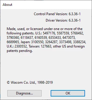

    I'm un-able to reproduce your problem on Windows 10 1903, Photoshop CC 2019 version 20.0.6 with the latest Device driver for my Nvidia Quadro K2200 with or with its GPU enable,.  The Autopan works better with GPU enabled.
    Using my mouse or mt Wacom Intuos Pro with the latest wacon dirver
