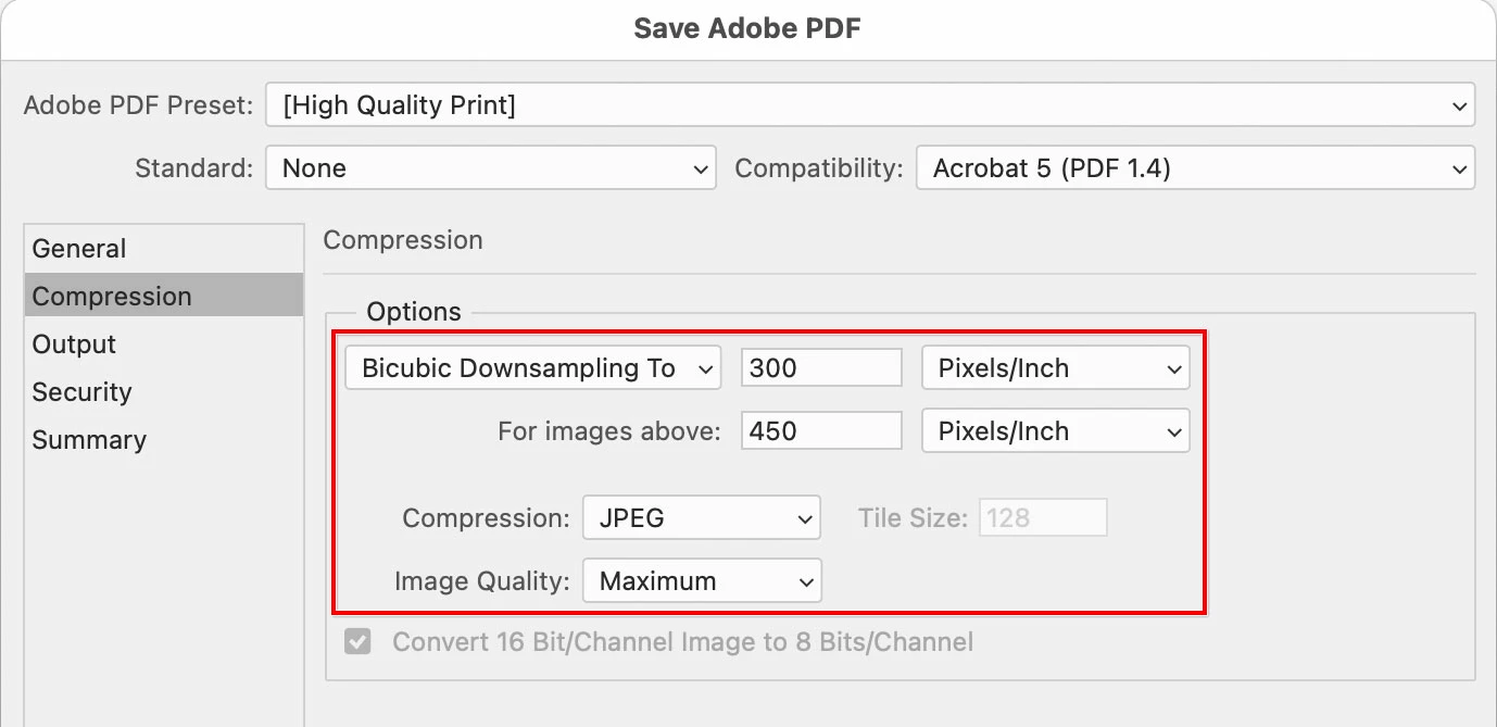

If the original scan was saved as PDF, that might be contributing to the problem. PDF is a container format, and an image can be included in a PDF at various compression settings. If the original scan was saved into PDF with too much compression or downsampling, the quality might be too low. Below is an example of the kinds of options that can affect image quality when saved as part of a PDF file, although your scanning software might not have all of these options.
To avoid the possibility that the image might end up with lower resolution or lower Image Quality, when scanning images for InDesign, the recommended workflow is to have the scanning software save them as TIFF or PSD (Photoshop) format, to preserve the full original quality of the image.
